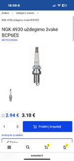

Are these spark plugs good?
NGK 4930 is BCP6ES which is a non-resistor plug and will work ok for M119 engines. This plug is 1 step colder than the normal Bosch F8DC4.
However, NGK 4930 is NLA / discontinued, and there are a lot of counterfeit NGK plugs on the market. Make sure they are genuine NGK from a reputable vendor if you buy any. I'd stick with Bosch F8DC4 unless you can't get those for some reason.
