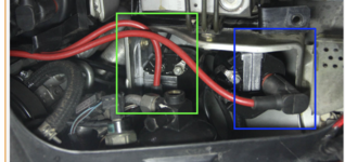

Hey Y'all, newbie here. I made a rookie mistake of removing all of the spark plug wires at once and thought I'd be able to place them back correctly. My question is, in the picture you shared of the coils the one on the left side that I placed the green square on, does it go to the passenger side cap or the drivers side. Any info is highly appreciated. TIA!
The coil in the green square goes to the passenger side. The photos in post #3 should help with the rest of the routing.
Also, as Jon noted in post #4, the plastic "X-tray" has numbers stamped on the bottom of each channel which specify the order of each wire, top to bottom. When routed correctly, it should look like the photos in post #3 above.

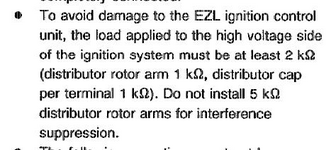

Can m119 lh handle a set of home made non resistor plug wires using a resistor plug like a ngk bk5re?
Also I'm using bk5re on 95 m119 5.0 with factory wires and it seems to run well...should I change to bk5e
Factory plug wires are non-resistor. There's only a 2k resistor in the plug boot. The system is designed for max 2k resistance for the wire + plug assembly.
Yup, you should be using non-resistor.
Ok ....if we bypass mercedes and make our own wires we will be 3k over in resistance specks with r plug and not compatible with the ezl requirement.
What if we go 0 resistor wires and plug set up without mbz boots we will be at 0 resistances....and would this cause harm or increase performance?
You're just complicating things and making work for yourself. There's no increase in performance to be found anywhere in the ignition system. Just leave everything stock. If you need wires, use these.
:shocking:
Used to make custom lengths with solid racing wire, inexpensive and in a way satisfying. Had big performance increase over stock with older sports cars, maybe N/A with 92 m119?
Might try it with mbz boot equivalent for some spare wires keeping 2k ohm specs acurate thanks to you!👍
The M119 ignition is light years advanced from any old distributor systems. Trust me, you are wasting your time messing with it. The only power gains would be from advanced timing, but the timing maps are fixed inside the EZL program and not adjustable. And, the stock wiring is already solid core, zero resistance.
:stickpoke:
:stickpoke:
I believe we agree :
1. no performance gain
2. mbz wires are solid with 0 res.
3. Ezl requires 2k res.
4. Beru wires and non resistor plugs highly reccomended.
