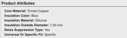

Maybe someone should try a set of the NGK RC-EU051 (54181) and see what the wire lengths are.
View attachment 148864 View attachment 148865 View attachment 148866
Note that the NGKs, like the MB and Beru wires, are copper.
