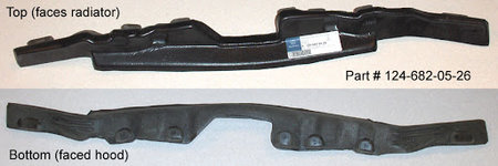

Unrelated observation... your hood is missing the foam piece that goes across the front, right behind the latch. That foam is NLA, unfortunately...

As for the center foam piece, is it a part used on all w124 or only 500E/E500? Maybe I can find it used from another w124...
As for the center foam piece, is it a part unique to all w124 or only 500E/E500? Maybe I can find it used from another w124...
If I remember correctly, it is used on all 124s with the automatic climate control system (or A/C). You should definitely be able to find one on another W124, but they are typically pretty fragile if not ripped and shrunk. If you do find one, snag it!
In my case, my 500E has no automatic climate control system... is it possible that it just didn't have the foam from the factory?
The same foam piece was used on all 036's. There is no footnote indicating otherwise.
This piece was phased into production somewhere in 1989 or so, and initially was for models with air conditioning, or with automatic climate control (which may have all had AC). But it appears to have become standard on all USA-spec models as of the 1990 facelift. It may have been optional on post-1990 models that were available without AC.
