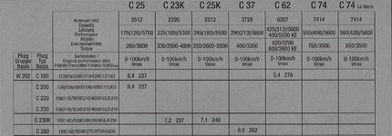

Does this mean the Carlsson C 56 engine doesn't have the same bore and stroke, and therefore the same displacement, of the M117 5,6 liter Mercedes engine? Being 5547 ccm out of 96,5 x 94,8 mm bore and stroke.
And to make it even more interesting. Carlsson also had a C 62. That engine however was also availible in a KE version. Since KE was before LH and ME, the C 56 engine must have been made later than the C 62 engine.
How odd is that? Since usually displacement grows.
Anyway, anyone here aware of this 5602 ccm M119 engine? And happens to know the bore and stroke also?

Right, Carlsson did some stuff with the M119, wich ended in the C62 '96/97 W210 100x98,8mm giving 6207cc 425ps 620nm, there I wonder
what crank did they use, billet or offset grinding?
It ended with the 6.2. But it also started with the 6.2. Since i read R129 KE 400 PS/600 Nm here.
That 5.6 must have been some sort of project in between? Who will tell? Guys from Carlsson (i contacted Stefan Mueller) couldn't tell me.
