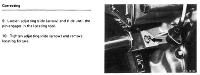

The nipple is used for adjusting the removable TDC indicator/pointer on older engines. See M116 FSM job 03-345. This has nothing to do with ignition timing, only setting the TDC indicator. OM60x diesel engines have the same thing, btw. M119 has a fixed, non-adjustable pointer.
