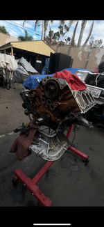

Exactly that, one of the guides fell apart and was disintegrated on my second day of ownership. Later found it made a new home as pieces all around the inside of the engine. After taking the heads off and seeing the amount of burnt oil buildup from the care of the previous owner i decided i might as well pull it and do a makeover as i intend on having this car for a long time.
I'm hoping all the extra work will help a little with help with its longevity but I’m sure it didn’t need it nonetheless. Everything was disassembled, the heads were done and oil pan pulled and cleaned but left the pistons as is so i guess not a total rebuild.

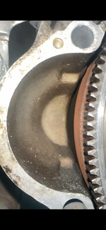

Heres a follow up got it on a lift and saw this wear, shop is closing so will have to check if the starter is loose tomorrow but seems flex plate may be cracked. Notice the fresh metal on the plate
Culprit came out to be a faulty starter/starter solenoid not retracting fully (0 001 110 053)

Quick recall, isn't there a spacer installed between starter and trans housing?
If that is missing the starter protrudes to far and can ge tin touch with the ring gear.
Edit - indeed there is!

Thats interesting you mention that as i have 2?
I pulled two off when taking the motor apart and didn’t think twice about them. But as it stands according to the document GSXR attached, they are installed correctly.
To wrap up this topic, solution turned out to be a shimming issue on the flywheel itself leading it to rub against the motor. My dad offered to install them while i was sick awhile back and didn’t think to check them later on. But turned out to be a good excuse to have the 4 speed rebuilt.
