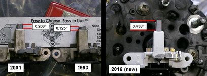

My used ML55 150A alternator bench-tested OK, but I also wanted to verify the condition of its voltage regulator brushes prior to any installation.
The 150A VR brushes still had decent life left but I opted to start fresh with a new OE replacement VR (Bosch 1 197 311 213) because I’m treating this upgrade as a “one & done” type of project that I don’t plan on revisiting. I’ll replace the 110A alternator's VR with the former 150A VR. The 110A VR will be trashed because its brushes are worn. Afterward, I’ll keep the 110A alternator in storage as a backup.
Poly v-belt removal is a prerequisite of alternator replacement, so I’m also using this opportunity to replace the 6 rib poly v-belt. The current v-belt is over 7 years old & upon closer scrutiny displays fine-checking throughout. I’ll keep this old belt in the car tool bag for a while as an emergency backup.
The Bottom Line: Consider replacing the voltage regulator prior to, & replacing the poly v-belt after alternator installation.

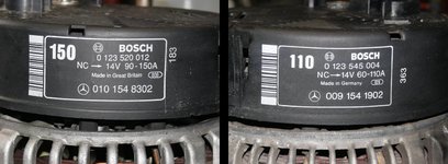

Part Numbers:
110A alternator: Bosch 0 123 545 004 (009 154 19 02)
150A alternator: Bosch 0 123 520 012 (010 154 83 02)

Looks great! FYI - per the label ratings, the stock alternator only puts out 60A at idle rpm, while the big boy puts out 90A. That's a substantial increase - 50%. This is the primary benefit to the upgrade, IMO. You'll rarely need over 110A peak output, but will often need more than 60A at idle...

Part Numbers:
