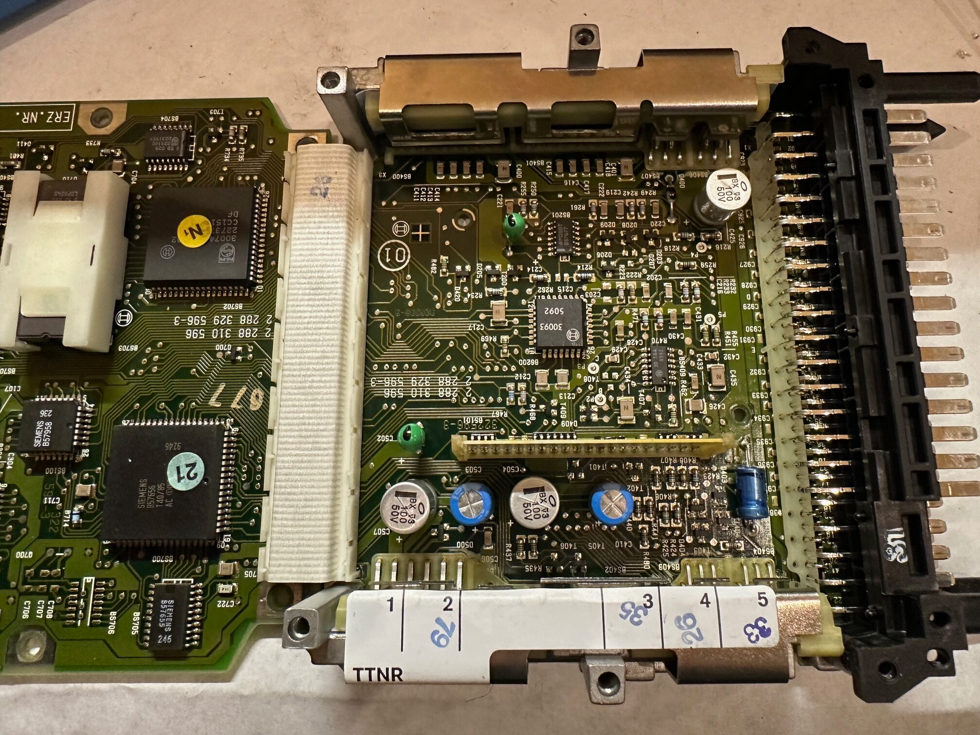

I just received another batch of capacitors to repair our LH modules today. I have 8 sets available and so far 2 have been spoken for. Updated pricing is $12 for a set mailed in a blister pack with tracking to your address. If you want 2 or more sets add $3 for each individual set. Additionally if you want me to install capacitors in your LH module the cost is $100 which includes parts and labor and priority mailing with tracking to your door.
What I have so far identified is there are some modules that have the newer style aluminum can capacitors and some that have the old brown plastic capacitors. The ones that are brown seem to be the ailing parts. Based on the age and lifespan of the components it’s still a good idea to replace them. I also will be replacing capacitors in the other modules in the box and will report findings on these modules if any are shown to be bad as well. I bought extra capacitors for these modules so if anyone is interested in having those updated let me know. Prices to be determined on those but they will be less than $100 since they seem to be fewer capacitors in number.
Another observation is Bosch stopped dipping the modules in conformal coating between 93 to 94. That may have been a cost cutting decision from Mercedes to control costs or it may have been deemed unnecessary. If your module has the conformal coating the coating needs to be removed around the components to be serviced. I reapply the coating after repairs are made.

It's most common on 1992 USA model year LH modules. Maybe some early 1993 USA model years. The capacitors changed on later modules (93-up, approximately) and those seem to have a much lower failure rate. It's unlikely the caps are bad on your 1995 assuming it's the original LH module.
