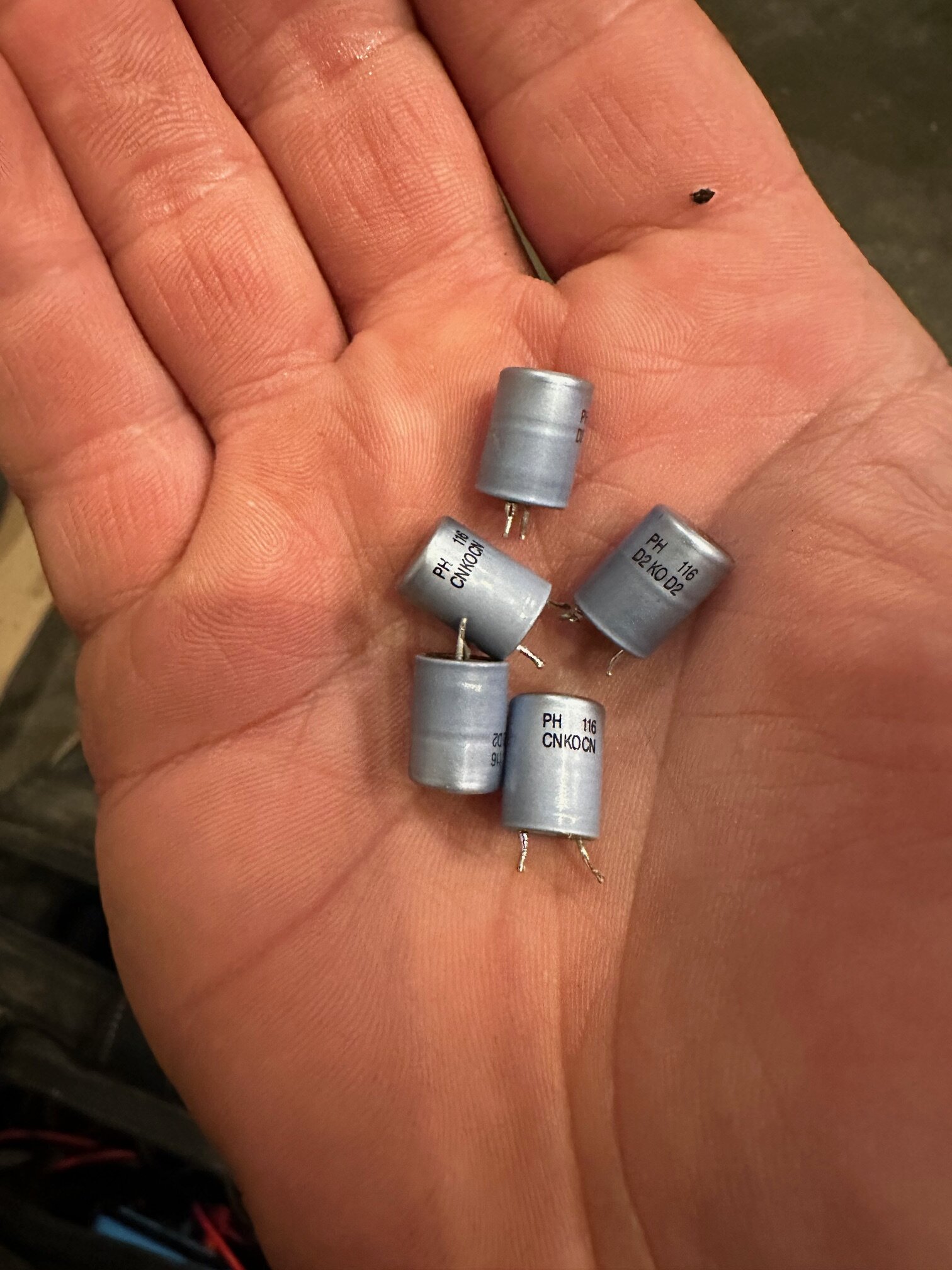

How wonderful! Might you have pictures of aluminum can vs. brown plastic capacitors?
I sent the brown capacitors back to the owner but here is a good picture of what they look like. Old B&O gear used the same vendor. I will be working on one soon and I came across this while researching parts sources. The ones in my hand are the new style and measured within tolerance but were changed anyway since they had to be desoldered to test they will be compromised due to the heating of the leads.

Just a follow-up: I had the aluminum can style capacitors and as @Alphasud40 mentioned they seem to be less likely to fail than the earlier brown capacitors. I checked the old caps and they were very close to the published capacitance. It’s still nice to know they’ve been replaced though.

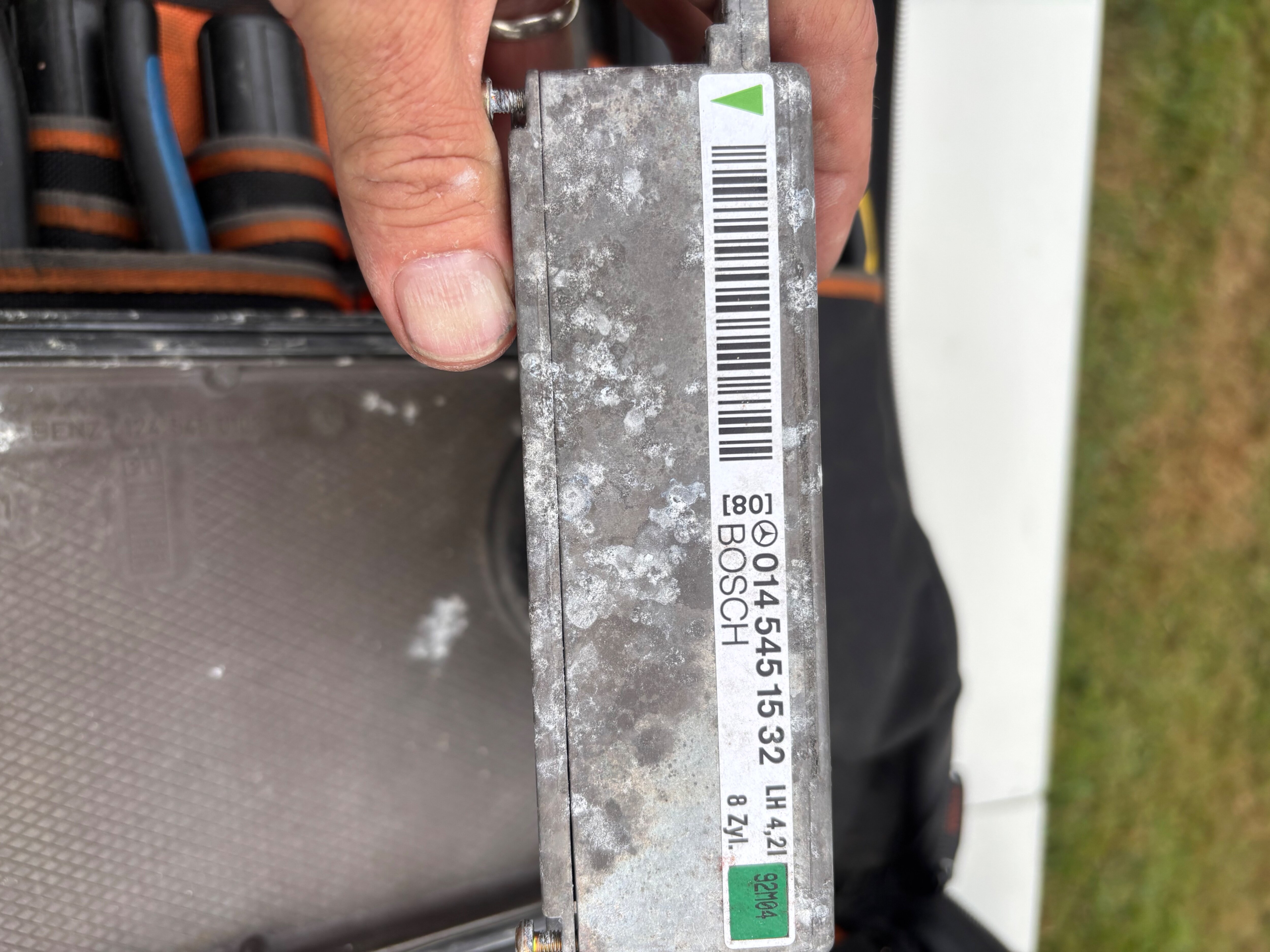

20250312_171558.jpgView attachment 210323
92 400e @ around 200k miles odo broke
Remove the 4 5mm Allen cap screws. You will see the ECU marked LH on the label. With a flat blade screwdriver gently lift on either side s
Where it slides into the slot. Back and forth until the unit releases
M119 engine idle smooth and ticking noise at fuel pump is gone...just like you and gsxr said ...good thing I didn't replace fuel pump! Find the problem before you fix it .....lh module was the problem not the fuel pump......@Alphasud40 knows how to rebuild the LH module
MANY THANKS
