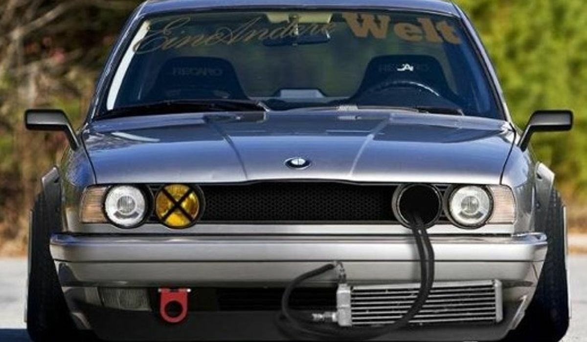

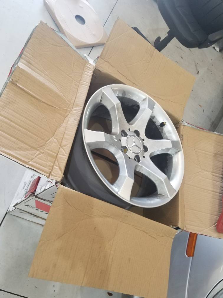

Also, I'm tired of the sleeper look. I want to give her some aesthetics, like a visible intercooler, mild drop, the new wheels I have, and an external oil cooler.

I'd add a screen over the external oil cooler... don't want a stray rock to punch a hole in it, and dump all your oil out. Especially since MB has no warning light for zero oil pressure, and the low oil level warning doesn't trigger for 60 seconds.

I used to run an intercooler exposed on the front of my diesel for two years and never had an issue with debris damaging it. If it happens to the oil cooler then so be it [emoji2369], it was meant to die a tragic death lol.
