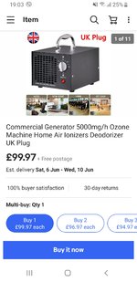

My S320's elderly PO was a heavy smoker long story short. The interior was deep cleaned including headliner but there is an underlying smoke odour that bugs me.
I have heard of Ozone Generators for removing odours from car interiors. As far as I am aware this is a one time treatment? Or might it need done more than once to kill off an older odour like that?
They are a little spendy but I cant borrow or rent one so my only option would be to buy one on Ebay. Just wondering what you guys think of them generally since they appear to get used more across the pond and arent hardly heard of here at all.
They do work, and yes, it may take multiple treatments (multiple hours of the machine running).
Even with the ozone machine, it will still take time for the odor to gradually dissipate. It's hard to get the HVAC ductwork cleaned out, assuming you have cleaned all interior surfaces+carpets. Additional measures may help, like using Febreze, or related odor-eliminating products like Odor Bomb.

I had a W140 coupe that was owned by a chain smoking Egyptian guy. Three days of a commercial ozone machine running in that cabin got maybe 90% of the smell out. When you sat on a seat you could smell it, as the seat padding was no doubt soaked with it as was all the upholstery and ductwork. I cleaned the ducts with AC cleaner, too, which also helped but did not completely eliminate it.
An ozone machine is just a part of the process, but don't expect it to be a 100% cure.
