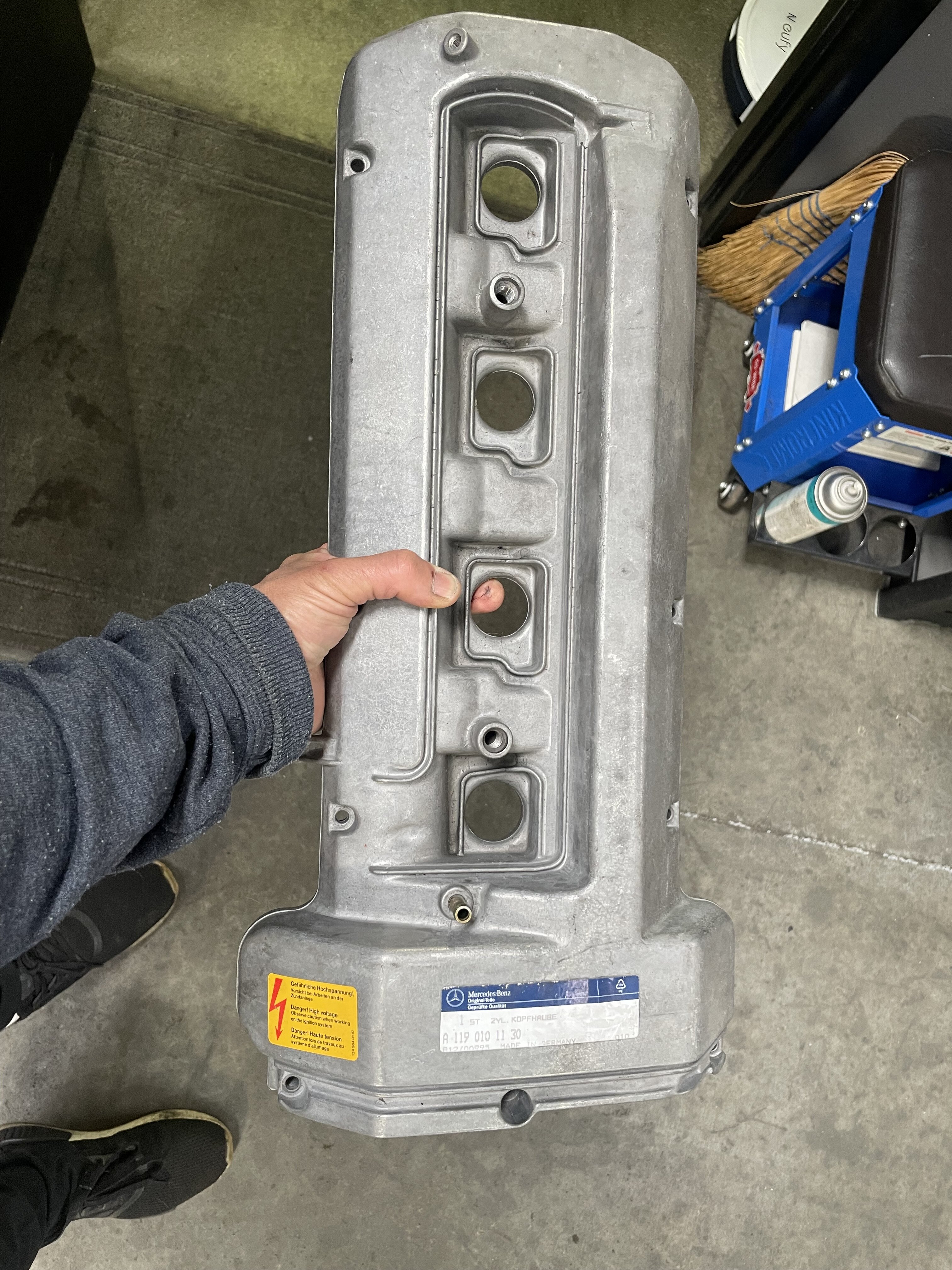

well I think I have the wrong side available.
Jeff
I do have one. I also find it hard to accept that the valve cover is the problem. These are cast, and it seems unlikely they would warp or twist.

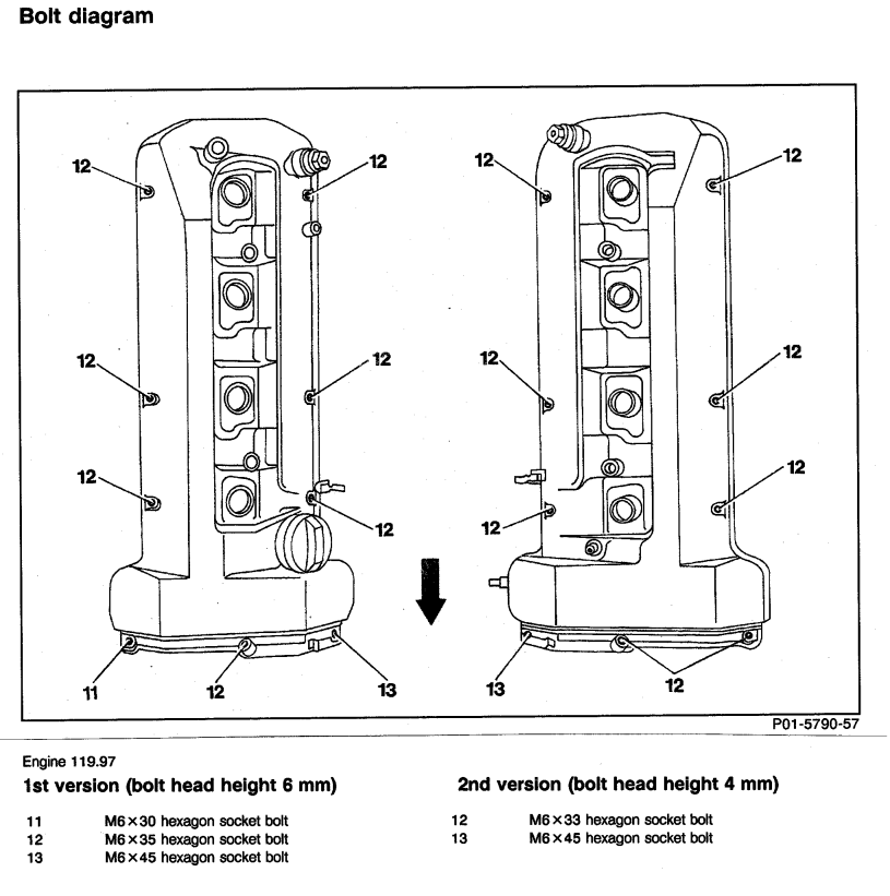

Bolts do not need replacement unless the heads are mangled. There are several different length bolts, which varies between early & late valve covers.
The copper O-rings are p/n 007603-006106, total of 18 required, get aftermarket which are a fraction of the cost of OE. And order a few extra in case they are dropped or lost.
A couple of the bolts changed lengths during production - see below. Can't use generic bolts, need to order MB. Unless the bottom of the bolt head is damaged, OR the hex socket is damaged, they should not need replacement.
The 9Nm torque spec is critical, along with new copper seals. But you can not get a torque wrench on the rear/lower bolts with the engine in the car. Use a torque wrench on every bolt possible, then for the remaining few where the wrench doesn't fit, estimate tightening them the same amount.

Dave,
Since I plan on doing this job in the near future, does that diagram apply to R/L heads?
What’s the reference to the 2nd version?
Is there an engine cutoff number that changes the bolt pattern?
