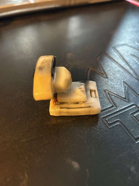

You are right on with your comment; I also removed the door panel on the driver side. To inspect all the parts and clean and lubricate the rail and regulator. On the left front, I found a broken plastic slide. Luckly that part is easy available. Part#126-720-00-42
