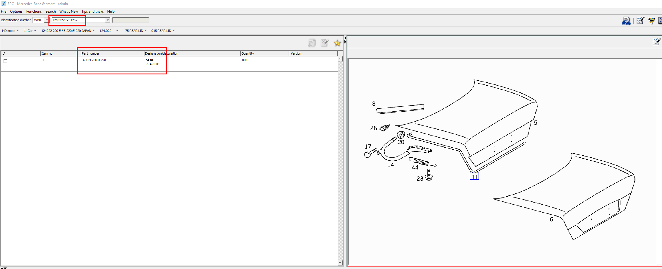

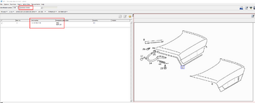

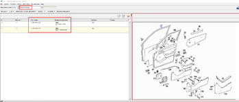

Boot seal 124-750-00-98 is for 1986-1987 models, and that's the old style which is glued in place. The 1988-up seal is a press fit.
Part numbers I mentioned above are correct for your Japan-spec 1995 E220. You really need to get the EPC and look up part numbers directly, to avoid getting the wrong stuff - will save you a ton of headaches!
:gsxrepc:

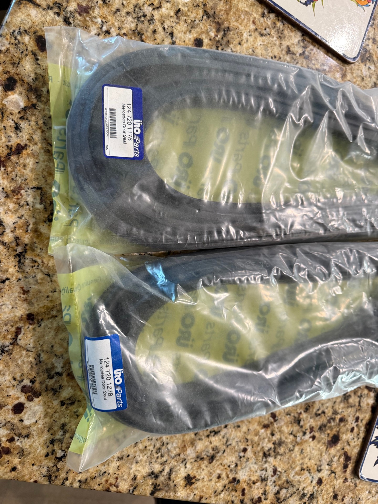

If you are interested, I have 2 new front door seals by URO parts, see attached photo.
I also have 4 inner door seals second hand off a 1993 model.
