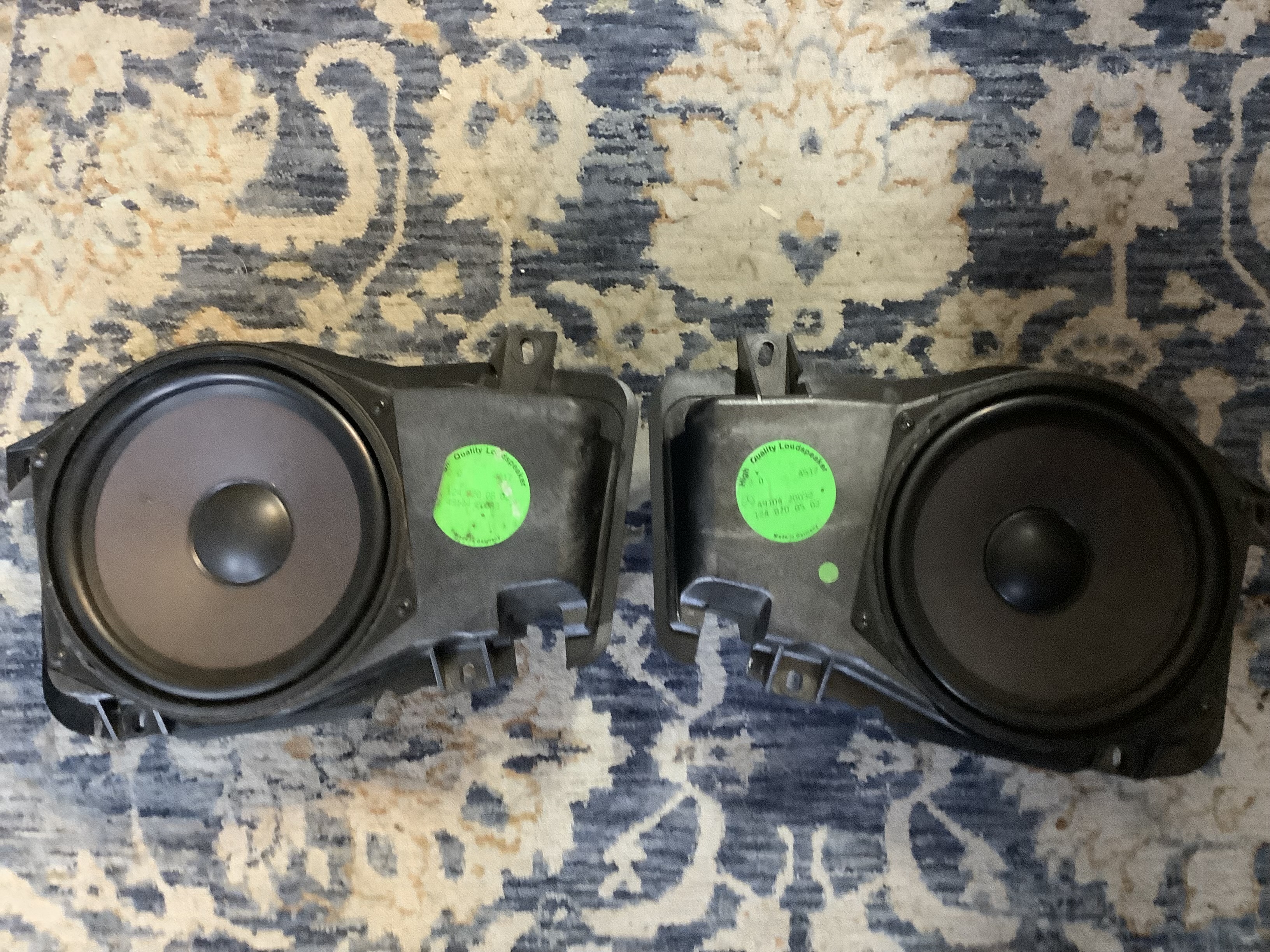

And these are the door speakers?
And will fit a 500 e?
Yes, the front door speakers that @northNH shows above with the Green decals are correct / original for all E500E (and, all 124 from 1991-up with optional Sound System). Note that Active Bass are standard door speakers, Sound System is the better / upgraded audio system with different / fancier door speakers. Active Bass was standard on all 124's in USA from 1991-up, Sound System was optional on most 124's but standard on all 034/036 models in USA.
Installation is easy AFTER you remove the front door panels, which can be tricky if you have never done it before. Watch some YouTube videos, better yet go to a self-serve salvage yard and find a 124 to practice on before attempting it on your 500E. Installation can be fiddly, make sure ALL the hooks are seated properly and the panel is 100% flat against the door before adding all the removable pieces back in place.
