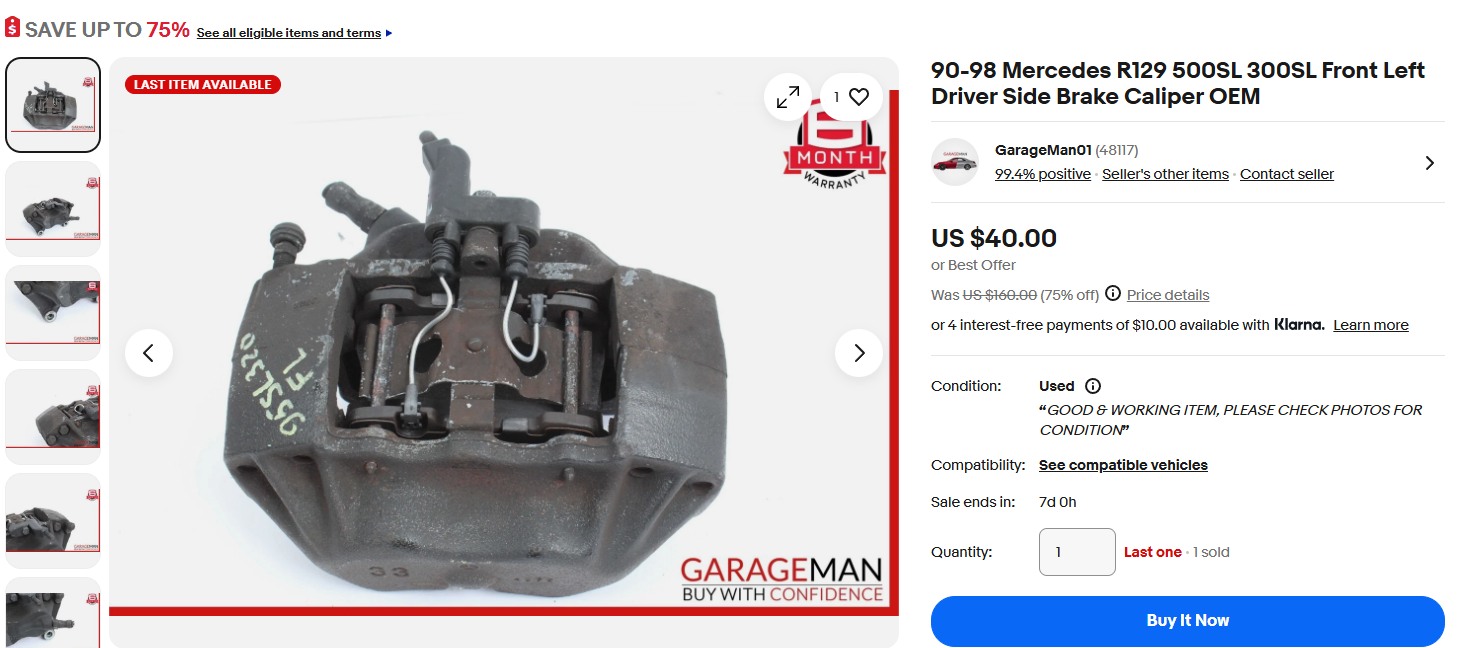

Thanks for the heads up! Is the Brembo caliper aluminum. If not is there a definitive way to identify an iron Ate? I did find a used caliper on ebay no indication of the manufacturer.

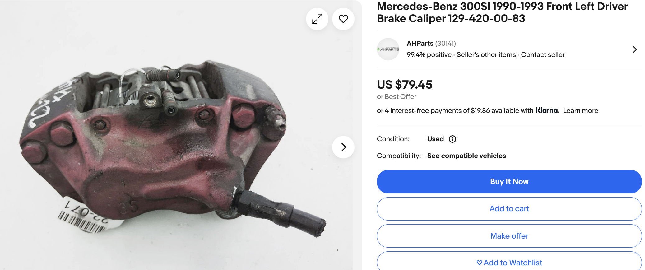

Yup, Brembo is aluminum and looks very different vs iron Ate. The caliper on eBay is iron Ate and appears to be the correct 300mm caliper.
The price is lousy though. Click here for one that's half the price, plus a Make Offer option, and might include new SuperChina pads.
