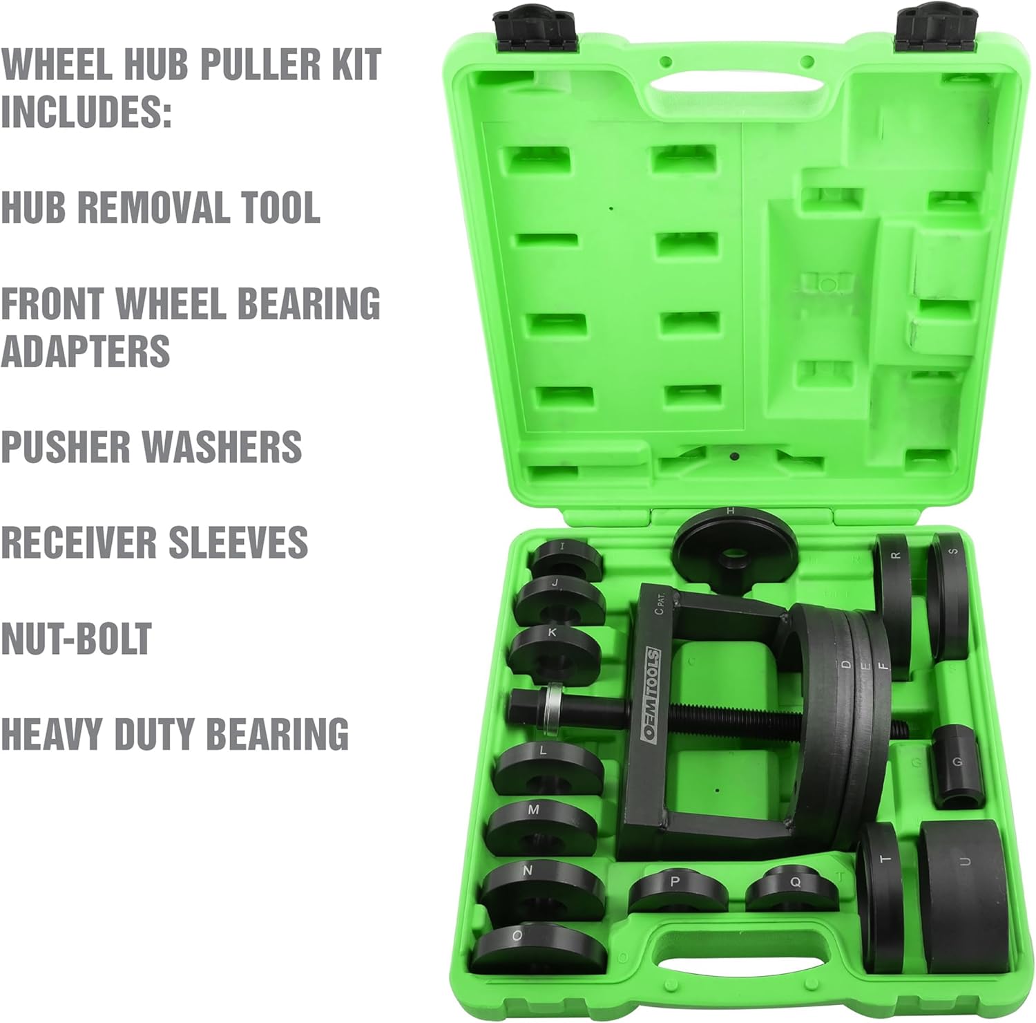

There are some offshore copies of the B90 tool now. See links below. Ignore the silly picture of the tool sitting on top of a brake rotor in the eBay listing. :rolleyes:
No-name kit, $182 with free shipping and a "Make Offer" button:
Name-brand (-ish) OEM Tools, $300 with free shipping:

I think it depends on the size of the slide hammer. The larger the hammer, chances improve. However, sometimes the hammer just won't be enough. I wouldn't buy a slide hammer, only try that if you have one laying around (and, an adapter to bolt to the wheel hub). If you have to buy something anyway, get the real tools. Both of the aftermarket tools above are quite a bit cheaper than the B90-M (which is ~$500).

J.M. - forgot to ask, do you have the tool to R&R the bearing? This is available separately, but if you don't have it, the B90 kits include the pieces needed to R&R the bearing.

If you gotta spend money, I'd shell out for one of the B90 clones instead. Those are guaranteed to work.
