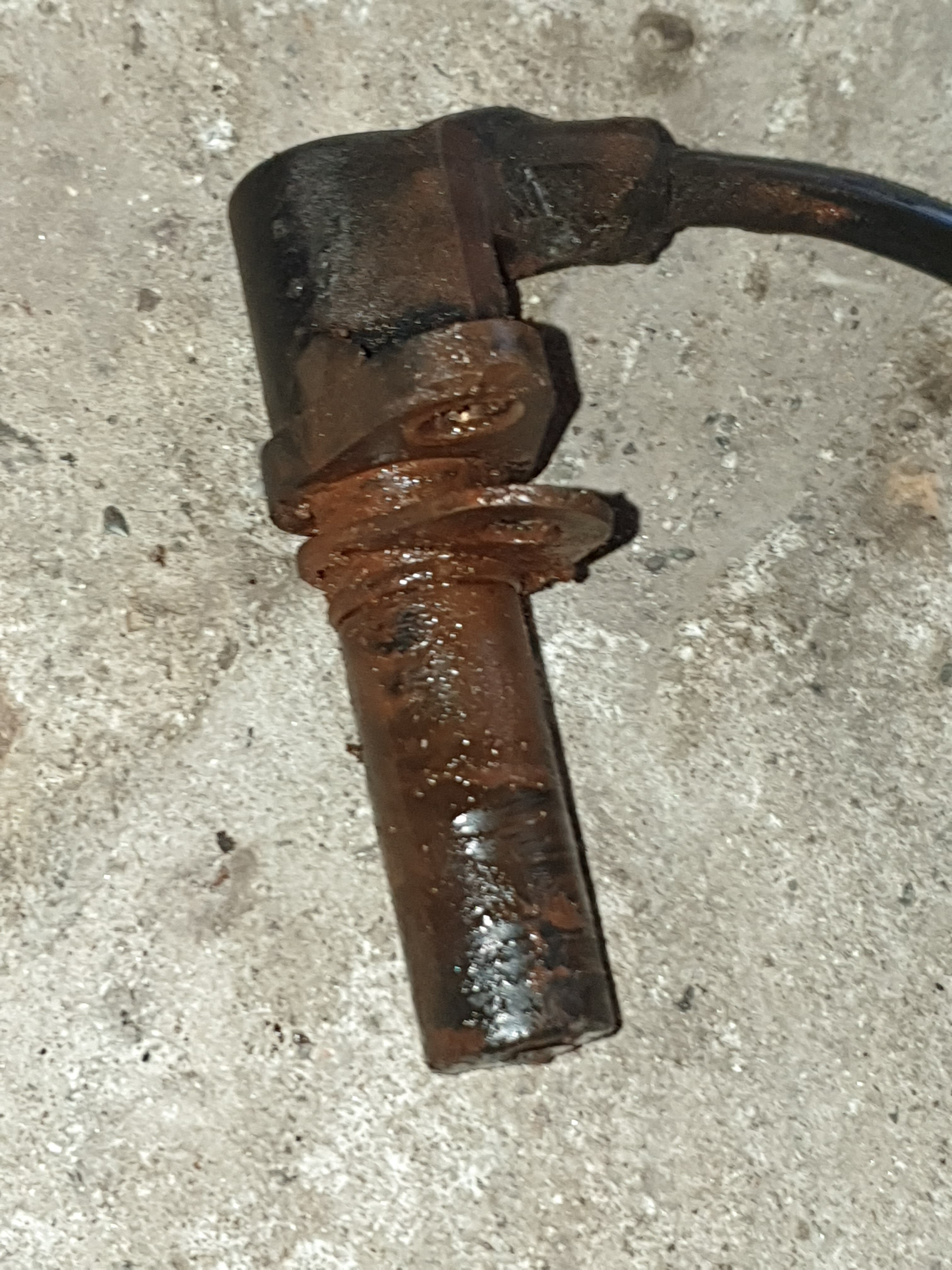

Did the design of the sensors change during the years? Mine that came out has a plastic top, but some sensors online with the same part number have a metal top.

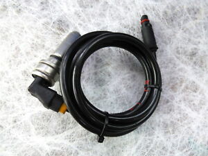

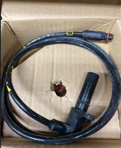

There may be a version with a metal body (tube) vs plastic. I found another photo of the plastic version below. I'm not sure if the plastic type was used in production or only offered as a replacement part.
The O-rings are different, and the EPC doesn't show this (EPC error). Make sure the O-ring matches the sensor (plastic vs metal). The O-ring for plastic is thicker and won't fit on a metal body.

All my diffs had this style with metal body and round metal can on top:
Found these photos on eBay of a plastic version:
