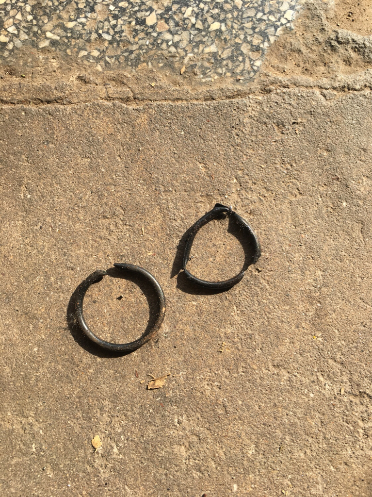

Guess what, I had pinched it. Yes I did use plenty of lube.
Then I pinched another seal.
On third attempt I had my colleague held an inspection camera whilst I lined up the seal. Very difficult to see the correct angle from underneath the car.. pushing at the wrong angle simply slices the seal.
Anyway, after a test drive, totally dry!!
Relieved!
