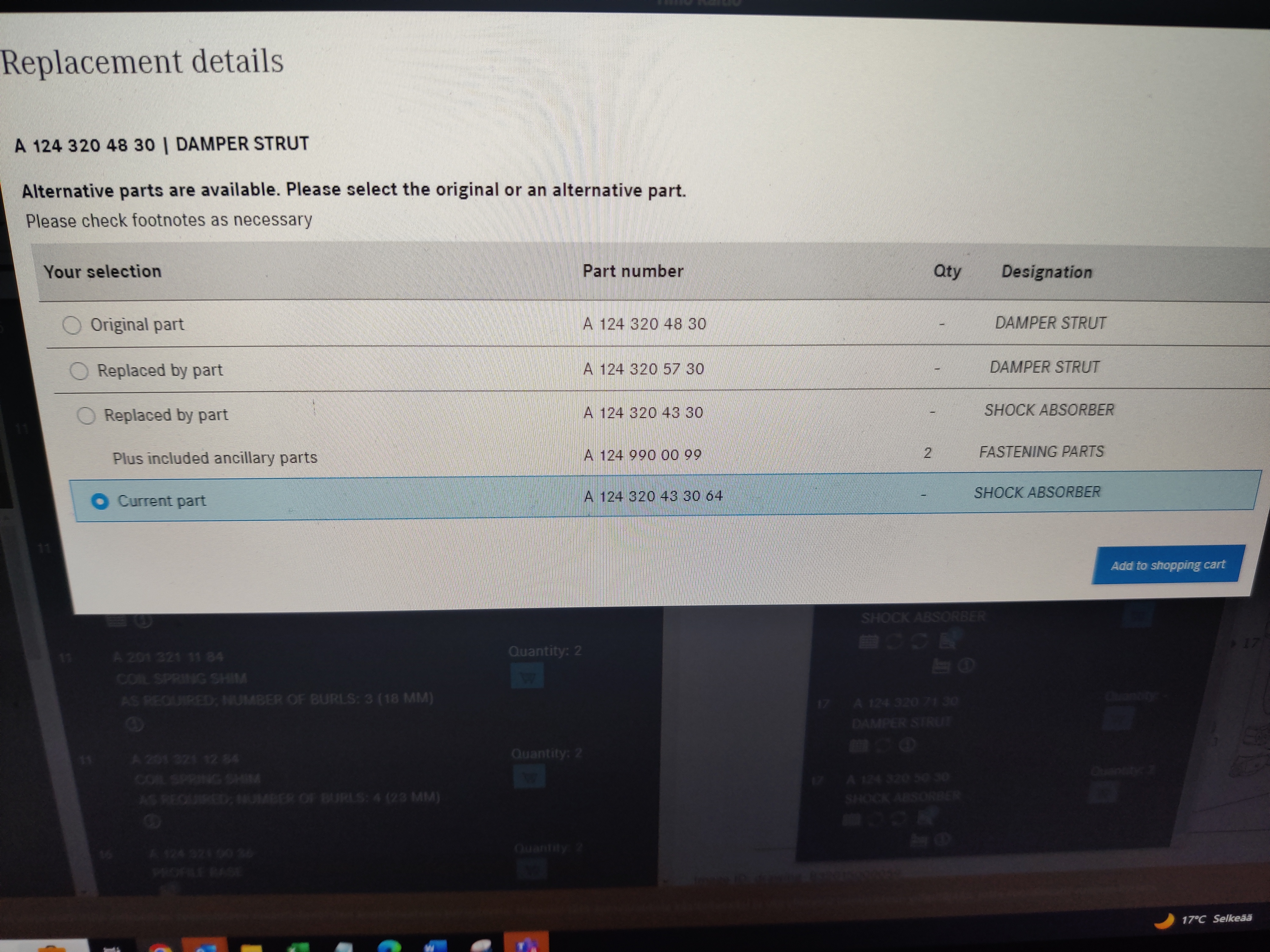

Xentry gives following part number:
A124 320 43 30 64
A1243204330 is correct for early 036 with M12 pinch bolt. And, you can use this on late 036 with M14 pinch bolt if you drill out the hole ~2mm. Early & late front struts are identical other than the bolt hole diameter.
The -64 suffix indicates a supplier change. In this case it will be Sachs, made in Turkey.
I thought that Sachs supplied all shocks to these cars? Or is that -64 suffix change also related when the production plant will change? I still bet that quality remains same as long as it is original Mercedes part depending where it is produced:scratchchin:
Correct, Sachs was the original supplier. The -64 suffix often indicates a supplier change, but in this case the -64 arrive still labeled Sachs, just made in Turkey instead of Germany. However, it could be related to Sachs being absorbed by ZF Corp, perhaps that is related to the -64? I really don't know.
