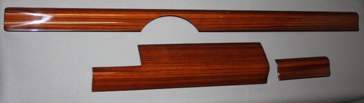

Hi All,
Was the timber trim along the dash board as below fitted to some normal pre 89 W124 models or only the AMG Hammers? It’s of course noticeably different to the trim introduced in the 2nd generation W124 interior.

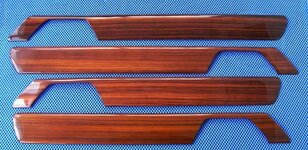

Only AMG. Not particularly Hammer. Wooden stripe what all 036 have was an option on pedestrian 124 ( second pic)

These wood kits in zebrano were fairly common in the 80s. There's also a kit that goes on the door panels that surrounds the handle. Some MB dealers even sold these as accessories, alongside the cheesy gold license plate frames. I wonder if the same company made these trims in different versions: zebrano, burl and maple.
The more exotic burlwood and maple versions may have been made exclusively for AMG (I haven't seen these sold separately) whereas the plain-jane zebranos were available to the general public (some sets pop up on German eBay occasionally).
Well, kind of. Are you looking to buy it? What kind? Zebrano or burlwood?
If I could get either I don’t mind I’d change my centre console to suit, my car is an ‘88 300E and doesn’t have any wood in doors or dash.
My centre console is Zebrano but I’d happily swap to burl if I could get my hands on a RHD set either way

The wood was standard equipment on 1990-up USA model years (aka MOFP-1). Get 1990-up door panels with pleated leather & wood, and a 1990-up dash as well, for a "factory" conversion. Probably need to pull the dash to replace the HVAC vacuum pods anyway.
As speedy explained above, the stick-on wood was an aftermarket thing. AMG only used this in the 80's because the factory wood didn't exist yet.

Ok so I’ve got this sorted, many of the kits around I found and including on eBay Germany adhere to the existing panels under dash and glove box. I have found a company here in Australia that takes the trim pieces back to plastic then fits the veneer to them. Just waiting for price and also restoration of my centre console panels so fingers crossed it is not crazy expensive.
I also notice Apsis USA sells the kits, has anyone had experience with them before?
I did manage to get a trim set sorted for my 300E, I had it finished in Birdseye Maple and it looks amazing see below photo of my trims. So the time has come soon to fit them, were the trim pieces simply adhered externally to the interior panels such as doors, dash etc. or was the vinyl and foam removed to recess the timber trims?

My friend in Germany has these full optioned AMG door panels that they call Mpof 1.5. They were completely done in Buffalo leather to match the Recaro Classic seats! 😍
He confirmed the the wood panels are just glued on top of the leather. Same for the dash and glovebox pieces.
