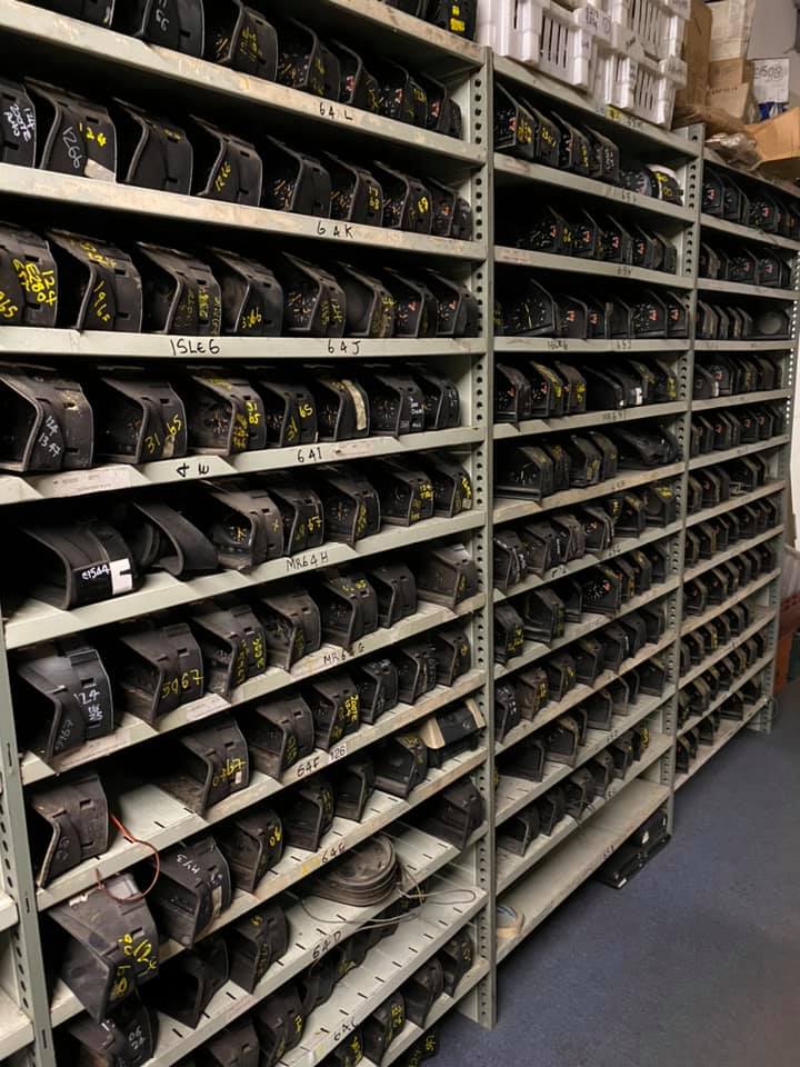

I think I have about 15 spare :oldman: But most are pedestrian units. And some w201 on top of that just because. (For when I get a Cosworth! 2021 plan to add one to the fleet)
Could a pedestrian W124 unit be converted to E500E specs by a speedometer restoration shop?
Yes, if they know what they are doing. The donor MUST be from another V8 car, as only V8's had electronic speedos.

C'mon, stop being modest. In your case, I am sure "few" = several hundred, if not thousands. :cool:
@JC220, I have obtained top-secret drone footage video evidence that details your stores massive hoard. Here it is. Please stop hiding the real number with your fake "15 spare" cover story. :thumbsup2::):omg:
My only question is how did you get this footage? I'll have to dig a bigger moat around the hoard again!
The photo is not dissimilar to reality actually :5150:

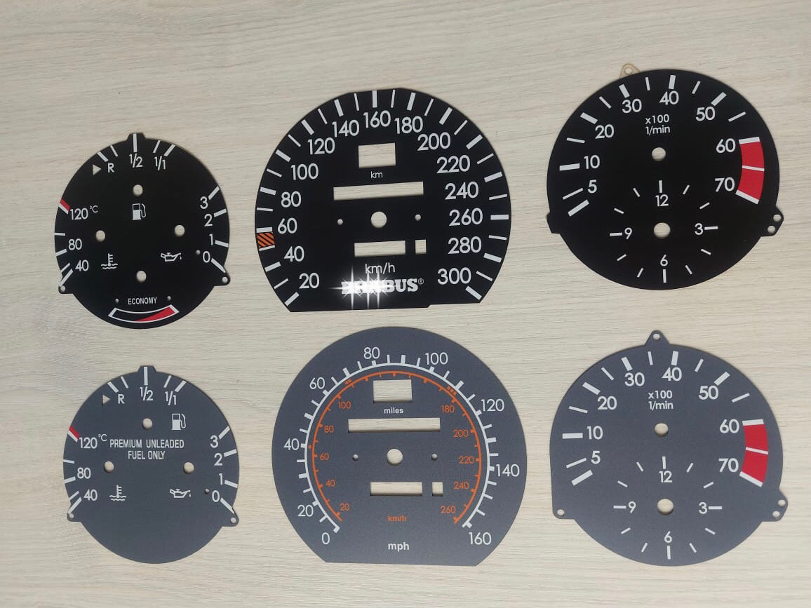

i can make new speedometer scale pads for both us version and european version
