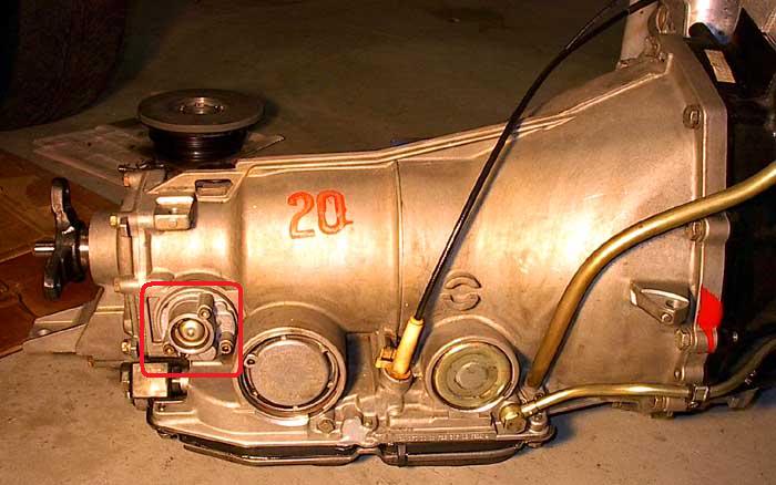

Attached is a photo of where the secondary pump is located. It's at the rear end of the transmission, just ahead of the tail-shaft (output shaft). If the transmission doesn't have a secondary pump, then it will have a metal plate over that hole. It's located on the side of the transmission that has the B1 and B2 piston covers, and the transmission cooler and dipstick....NOT the side with the neutral safety switch.

Gerry thanks for your help ,how do I visualize the secondary pump?I do have the intermediate plate that came with the E420
so confused
