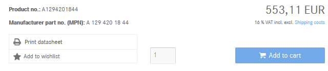

Both sides are NLA. And €500 each is just silly. Ten years ago these were less than $100 USD list price each.

Unfortunately this MB Online Shop is not always up to date. Your order will be canceled, if you try to order them.
I mainly use this site to check the availability and price before contacting to local shop, but good to know that there is a uncertainty. Thanks.
The MB Classic Center Parts Search is always up to date. Highly Recommended.
