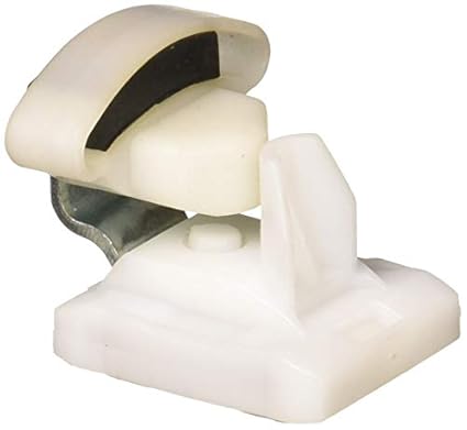

Ok, I found out what the problem is. It's a $5 part from the dealer. It's a little tiny square plastic part that holds the throttle cable in it's bracket.
Glad you found it. Its not a bad Idea to have a spare, OE get brittle with age and heat. A good time to replace this when one doew a new fuel pressure regulator or vacuum connector refresh.

Glad you found the problem. I’ve had that same issue in the past on my Euro 84 500SL and my long gone 86 300E. Unfortunately, (for me) in both instances, my Wife was driving the car. Both would start and idle normally but step on the throttle and NOTHING!! On the 500SL an approximately 1” round plastic ball disintegrated. Wife left / abandoned the car in the middle of a freeway off ramp in Anaheim.
The 300E almost the same part disintegrated. This time she had three other ladies with her (one a cancer patient that they were taking out to lunch) .
I received a “SMOKING :hot:PHONE CALL” in both instances that I remember to this day. My ass still hurts:runexe:
Both cars towed home. Problem diagnosed within about 1/2 hour of lifting the hood (bonnet to the Brits)
Both plastic parts under $5 and about a 1/2 hour to repair. But the pain still lingers.
NOTE to SELF >> CHECK the 500E!!
Better Yet, Just REPLACE the PART!!

This part has been superseded to part number 202 301 00 93 64. The MB list price for this part is $2.00, and it can be purchased at the normal "discounted" dealers for around $1.50. I have ordered four of them for my deep parts archive.
