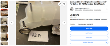

Hello,
Just wanted to let you guys know, the Dorman part# 603-643 is actually a much closer match to the original even though in display pictures it shows like the incorrect one shown above in @gsxr 's post.. I'll add a picture in the morning to show once installed, the level sensor and outlet port are in correct orientation, only the bleed port and vent port are different but totally usable...
Cheers
I found photos of the Dorman here... looks identical to the M103 tank? If so, might as well get the OE tank for the same price.
I got something different for sure… don’t know if they sent the wrong part but was ordered off Amazon under that Dorman part number. The bleed port hose has plenty of length to comfortably reach the new location on new part
Welp install was great, fits perfectly, I did change out bleed hoses for silicone with a bit more length to be safe, stoked on it for $30! Took pics of what part numbers are on it, I’ve found 90% Dorman parts end up being German made or exact OEM in last few years…
