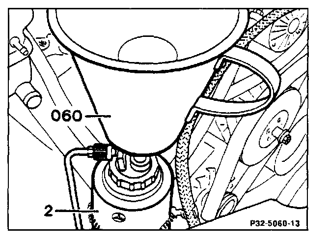

check and if necessary add hydraulic oil 000 989 91 03 using funnel 126 589 12 63 00 (item 21).

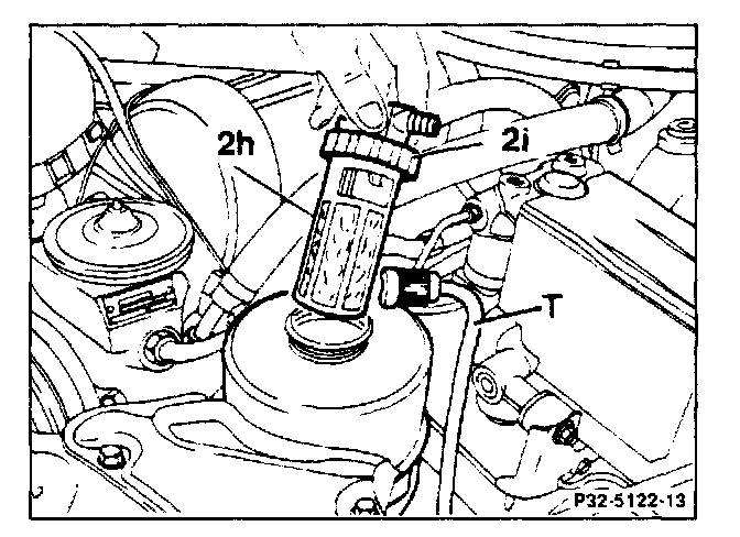

1 Disconnect return line (T). Unscrew union nut (2i) and remove oil filter (2h).
2 Check for clean oil filter and install. Connect return line (T).
Note:
If the oil filter is contaminated, the results of this testing will be inaccurate.

18 Pour collected oil through funnel with filter (060) into oil reservoir (2).
Note:
Re-use clean oil only.
