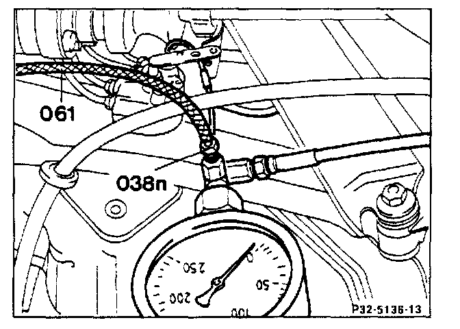

Oil drain hose:
attach, remove at the bleed screw.
Bleed screw on pressure tester (038):
open slowly and release pressure, collecting the oil in a clean container. Close bleed screw (item 13).

12 Attach oil drain hose (061) to bleed screw (038n).
13 Slowly open bleed screw (038n) and release pressure. Collect oil in a clean container.
