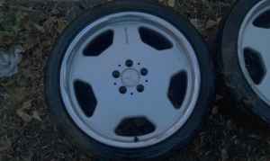

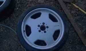

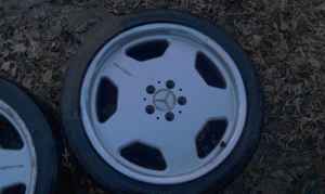

Someone was looking for a set of these a while back and there was doubt that they were ever produced. These appear to be genuine:
http://newjersey.craigslist.org/pts/2690916468.html
Mercedes AMG 19" mono block wheels used - $750 (north jersey)
Date: 2011-11-07, 9:35PM EST
Reply to: sale-yxunp-2690916468@craigslist.org
i have a set of staggered Mercedes AMG 19" mono block wheels. These are original factory wheels not cheap fakes. fronts are 19"x9" the rear are 19"x9.5", tires need to be replaced. The rims are in good shape. There is a few scratched on the one rim. They are easily repairable by a rim repair company. I'm looking $750 or b/o. cash only, contact via text or email only. 973-222-8271.

I think I was the Doubting Thomas on that one and at the time someone said they were produced/available.
I take it that these 19" Monos are a bolt-on for our 036s, no?
This is the first set i have ever seen. Since they were produced for the S class, the et would be something close to 44. Fitment to our 036 would require 12mm to 16mm spacers and most likely 12mm wheel bolts with 14mm ball seats.
drew
Drew summed it up exactly ;-)
I have seen a set on a W140 and did look very closely at them. Although I was not able to verify any type of part number, then did have the recessed AMG logo on the front (have also seen several sets on Ebay for sale). I have also seen 19" copies (no AMG logo) and these were available in proper offsets and lug sizes for the W124.
With that said....I did take a look for the 19" AMG's in a 1996, 1998 and 2005 AMG wheel catalog and was unable to locate them.
Here is a set that was for sale on Benzworld that lists the offsets
http://www.benzworld.org/forums/sale-wanted-trade-giveaway/1508558-fs-19-amg-monoblocks-w-tires.html
This auction has a picture of a 500e with a set of 19" AMG copies. Seen the car before, believe its from Oregon and was for sale a while back
http://www.ebay.com/itm/Mercedes-W1...09261850&pt=Motors_Manuals_Literature&vxp=mtr
