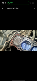

Check for running rough 1
removed cylinder head as no compression on cylinder 6
Found engine failure due to valve seat fallen into cylinder causing damaged to piston and
Cylinder head
metal particles through out engine which would need to be cleaned as best as possible
May require further parts once completely stripped down
requires rebuild but advise new engine

I'd purchase a new engine and transplant parts. Don't mess around with shavings and metal in the engine. You will need a competent shop who knows what they are doing, and are familiar with the M104.
