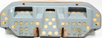

There might be some truth to this. Assuming that chassis development of the 500E was happening in the late 80s, the rear seats available for prototyping during that time would be the early W124 (MY86-89) type. Early rear seat bottoms are indeed different than 90-95 models, but I'm still not sure what the "seat suspension" issue was.
Early W124 rear bench cushion: s-l1600.jpg
Late W124 rear bench cushion: s-l1600-4.jpg
Thanks for the photos, Aaron! If anything, it looks like the early rear seat would have more room since it's all "open".
The rear subframe and differential are all located behind the rear seat floor pan, so none of those components should affect rear seating. If the larger subframe/diff really did cause problems, the .034 would not have existed with 5-place seating, or would have had a different rear seat bottom unique to the .034 chassis. The EPC indicates this is not the case.
