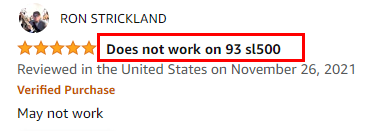

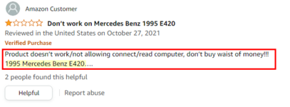

Note that for the iCarsoft adapter you bought, almost all the reviews (link) are for new models that already have OBD-2 connectors. Read the review below from a customer with a 119.975 which has identical engine controls to your 119.972. Plus another one with YOUR EXACT YEAR AND MODEL saying it does not work. Also, a lot of the reviews smelled very shill-y to me... more like paid reviews, not genuine.
