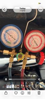

Hi guys , AC intermittent. compressor engages ,I put the gages low pressure I think is ok high side does not go up .AC does not cycle on and off . ambient temperature 85 . I suspect expansion valve or compressor not pumping . what are your thoughts .

High pressure is 150psi so the compressor is compressing. I assume vent temps are like 60-70F?

I just went to my Mechanic friend who has the big machine he did a vacuum then added 2.2 pound and the high-pressure is not moving just like that picture he suspects the expansion Valve
With a full charge... yeah... the TXV would be my next guess. There is nothing else in the system that would cause this, AFAIK.
However - what are the vent temps? If it's blowing 45°F air out the vents, I wouldn't worry about the gauge readings.
