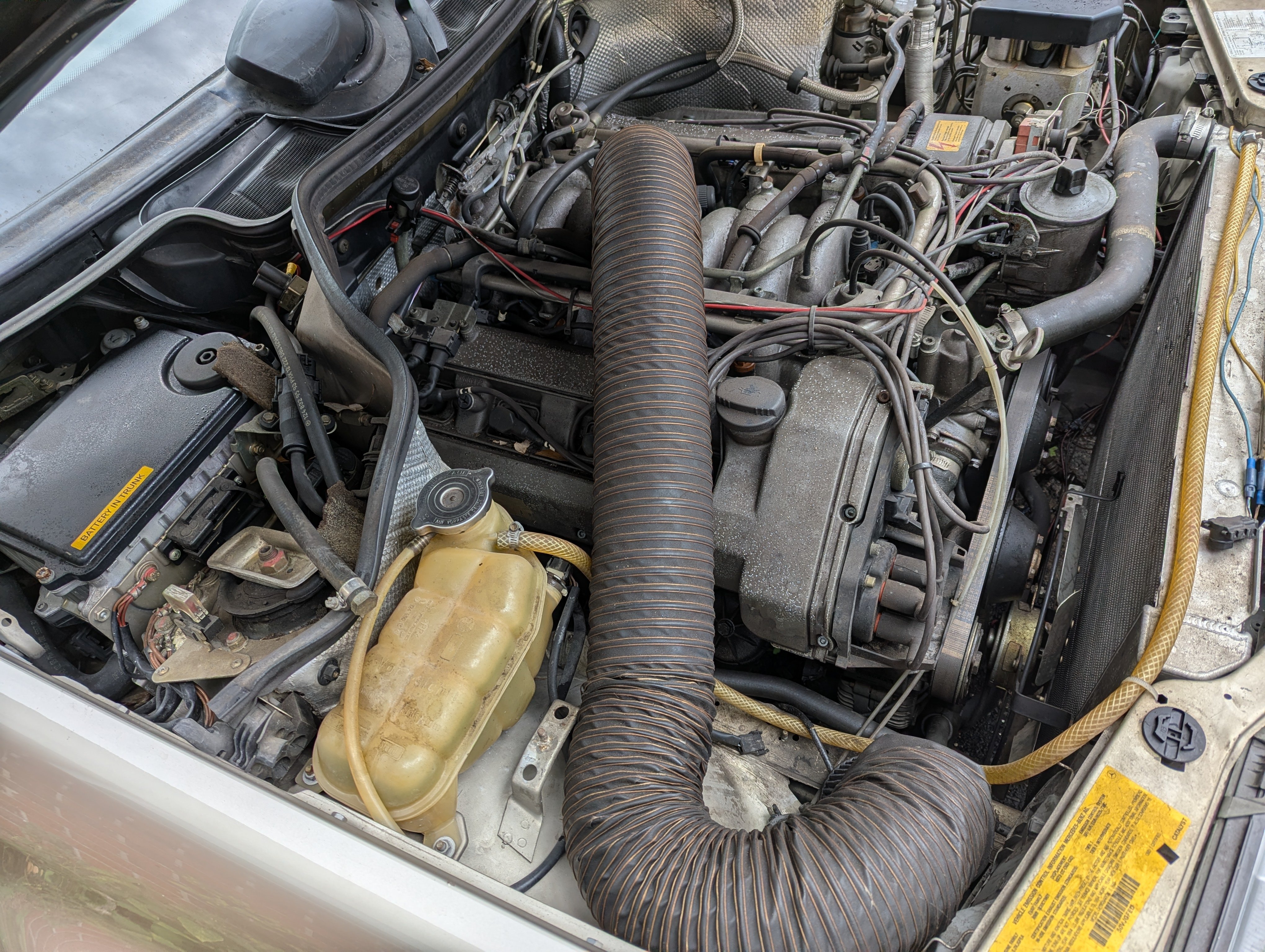

I need everything from the intake manifold up. The previous owner removed everything and replaced it with a hot rod filter. As I'm a newbie with this model, I don't even know what I'm missing. Are there other models of W124 that use the same components?

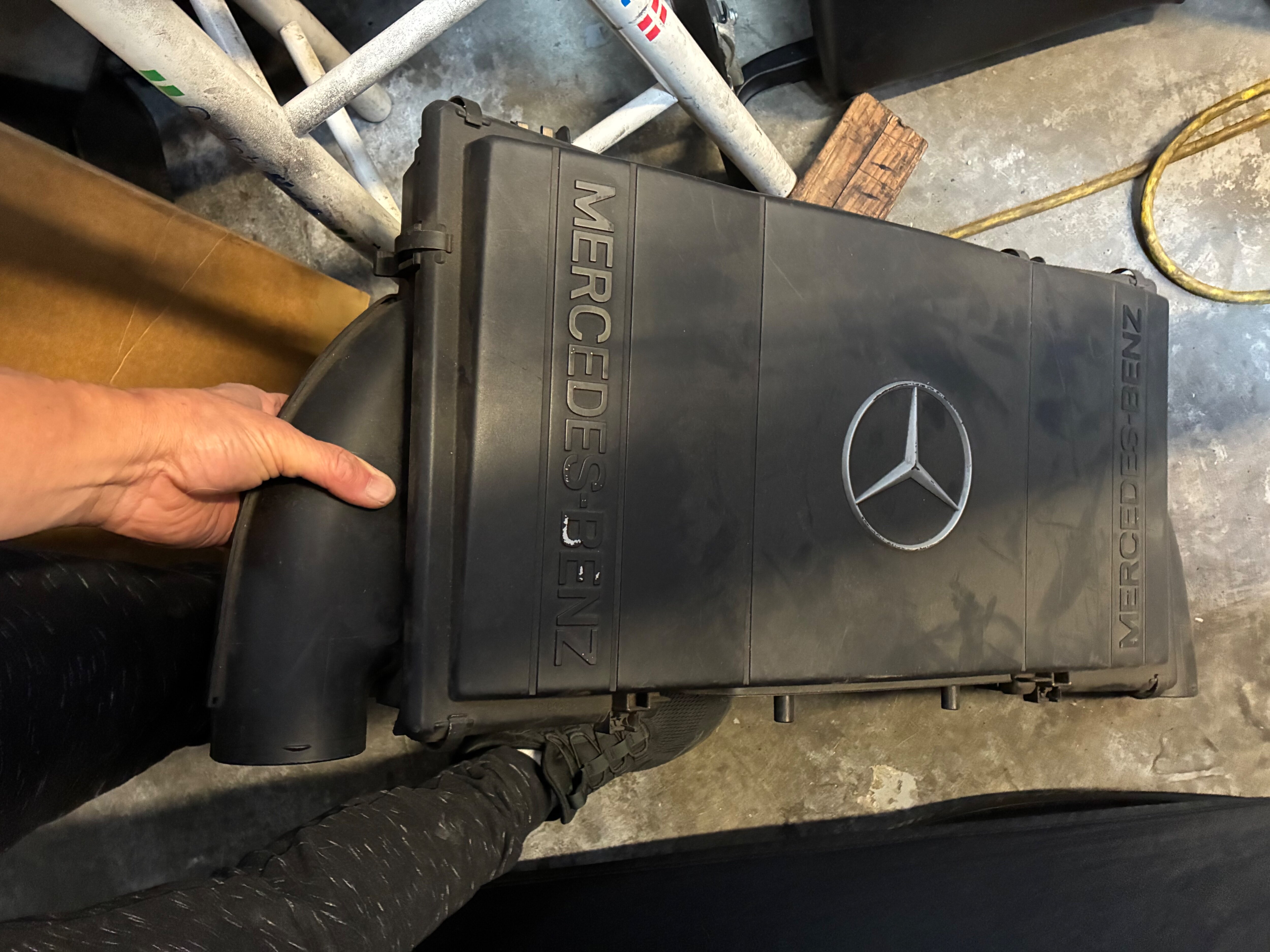

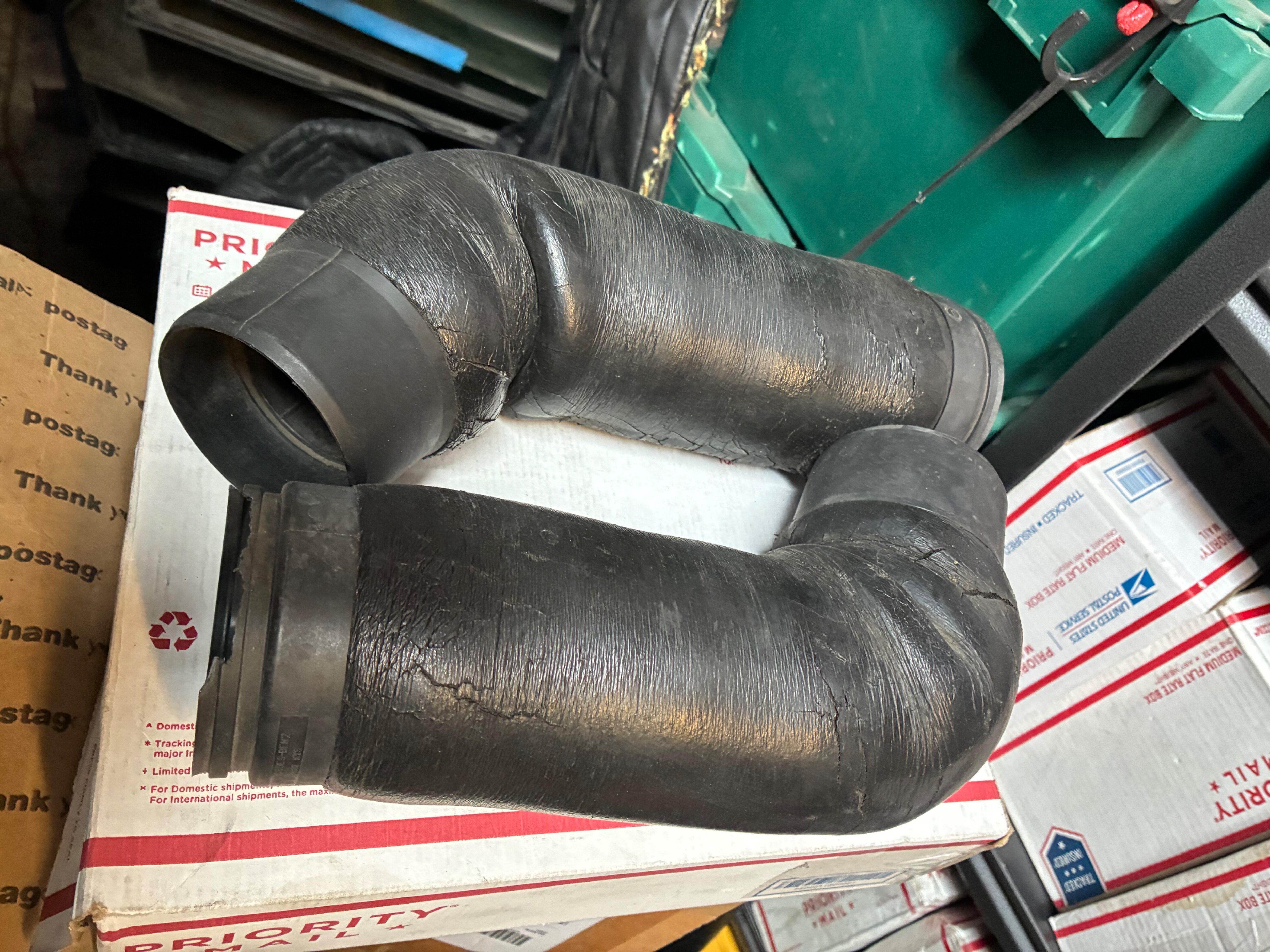

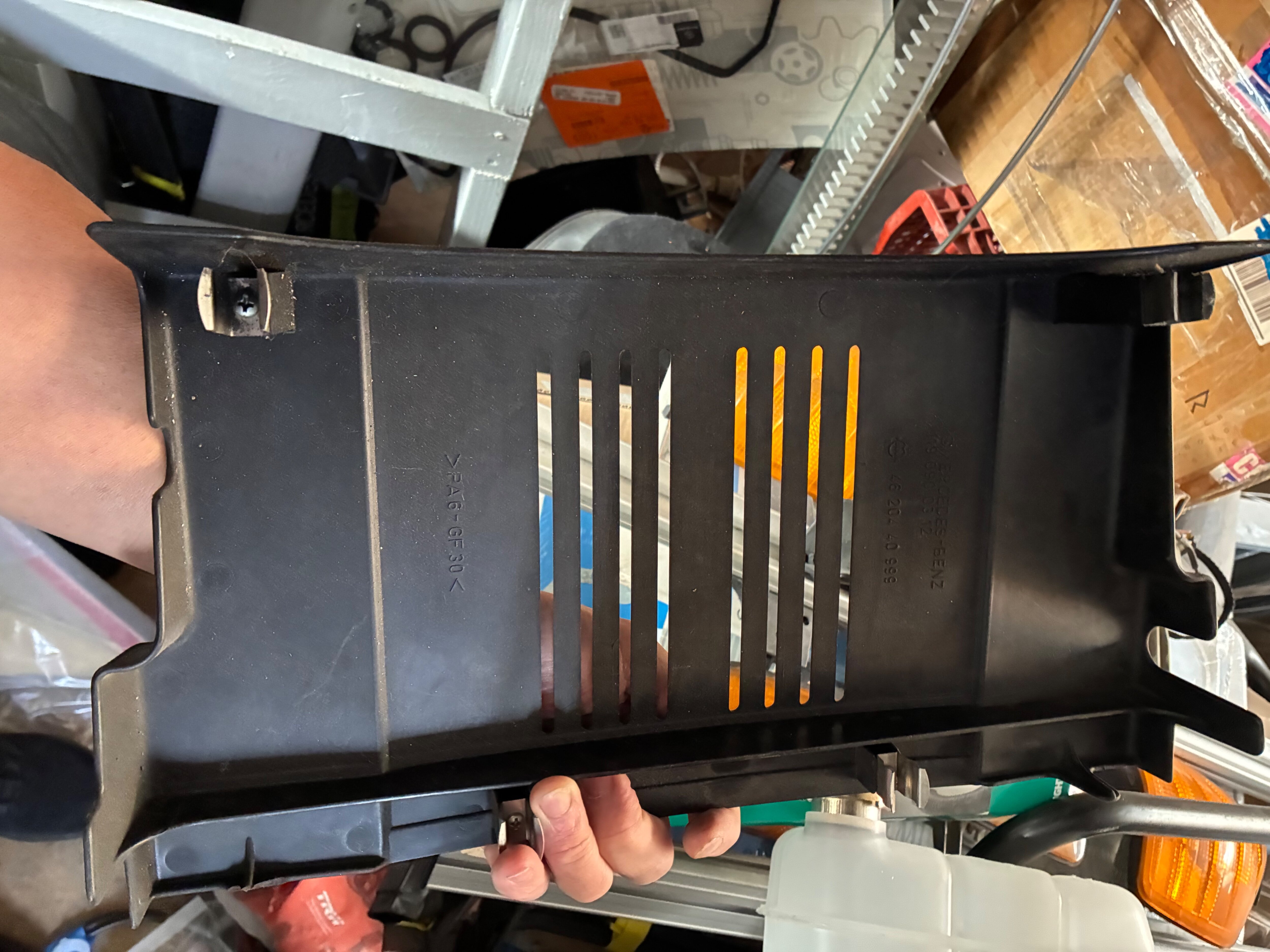

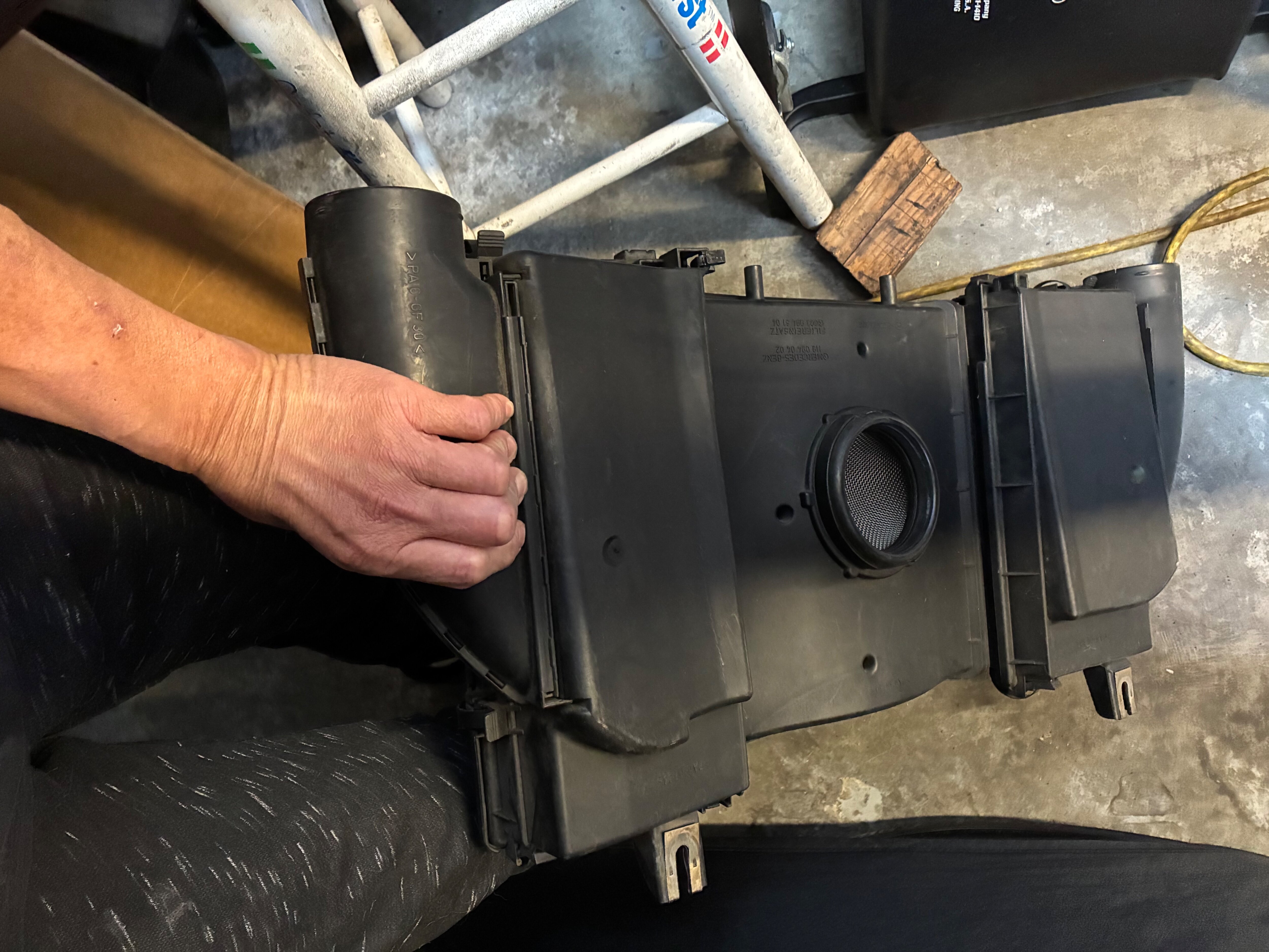

I have the upper and lower portion of the airbox available. I'll update with a few images

Yup, what captruff has is the correct airbox and inlet tubes (Zoom tubes).

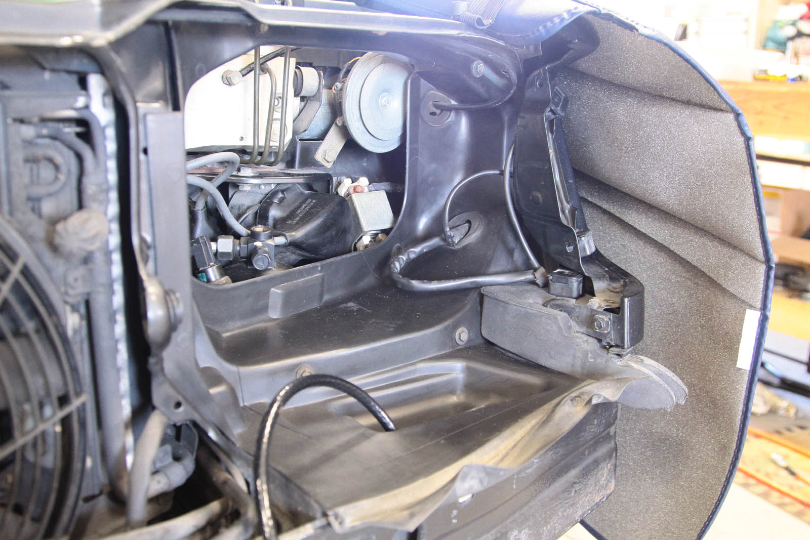

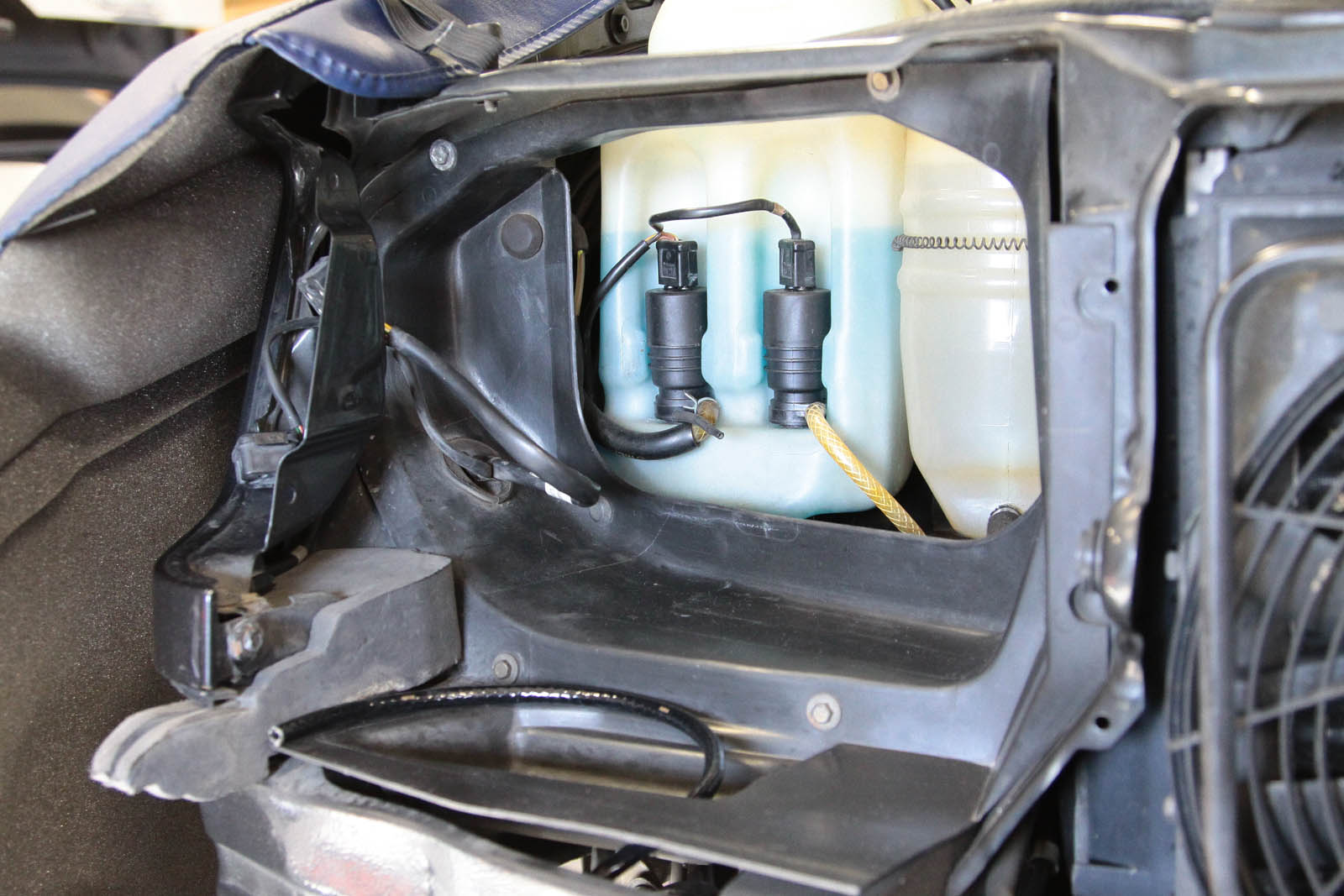

Sheward has a good point - I am not seeing the enclosure around your headlights. Could be the main enclosure is present and you only need the back piece with the Zoom tube connection? Would need better photos of the back of both of your headlights to confirm. The "enclosure" is not fun to R&R... need to pull the headlights for starters. Looks like the pics below, after the headlight is removed.

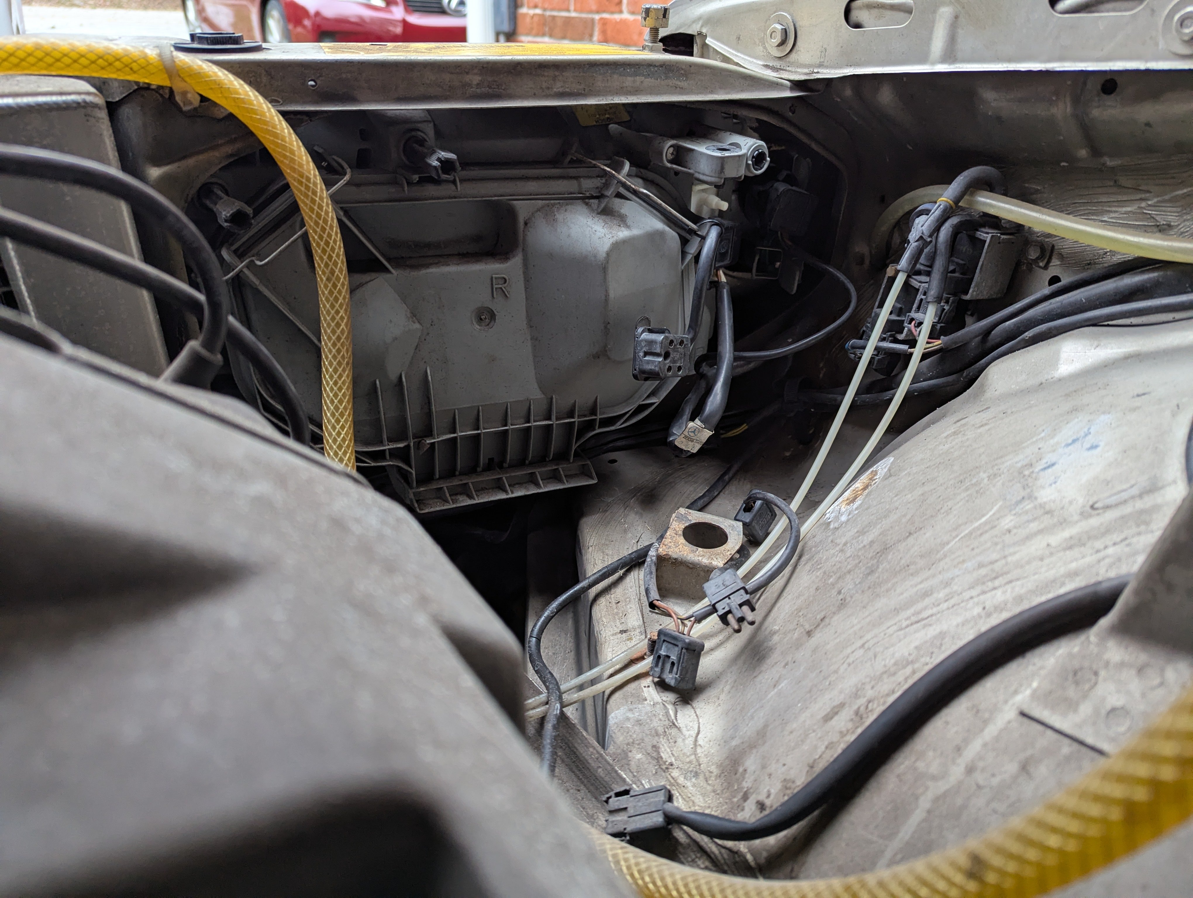

Attached are photos of the back of each headlight enclosure.

I think you are missing the complete plastic enclosure for the headlights. Wow, that's unusual. It's a lot of work to remove those. This car is a 1994 E500, right? Strange!

What you see in my photo behind the left headlamp is the anti-theft alarm horn. You should have one there also, unless it was removed.

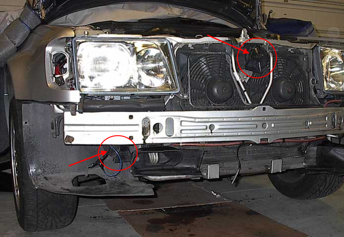

The primary horns for a 1994 E500 (and all E500E) are in 2 locations. One of them is in front of the AC condenser, the other is located behind the bumper near the passenger foglight. See red arrows in photo below on my 94 E500. All other 124 chassis have both horns in front of the AC condenser.

Yep, looks like the entire plastic surround that fits into the frame around the headlights is missing. Wow.
You can see more examples of this missing piece in these posts:

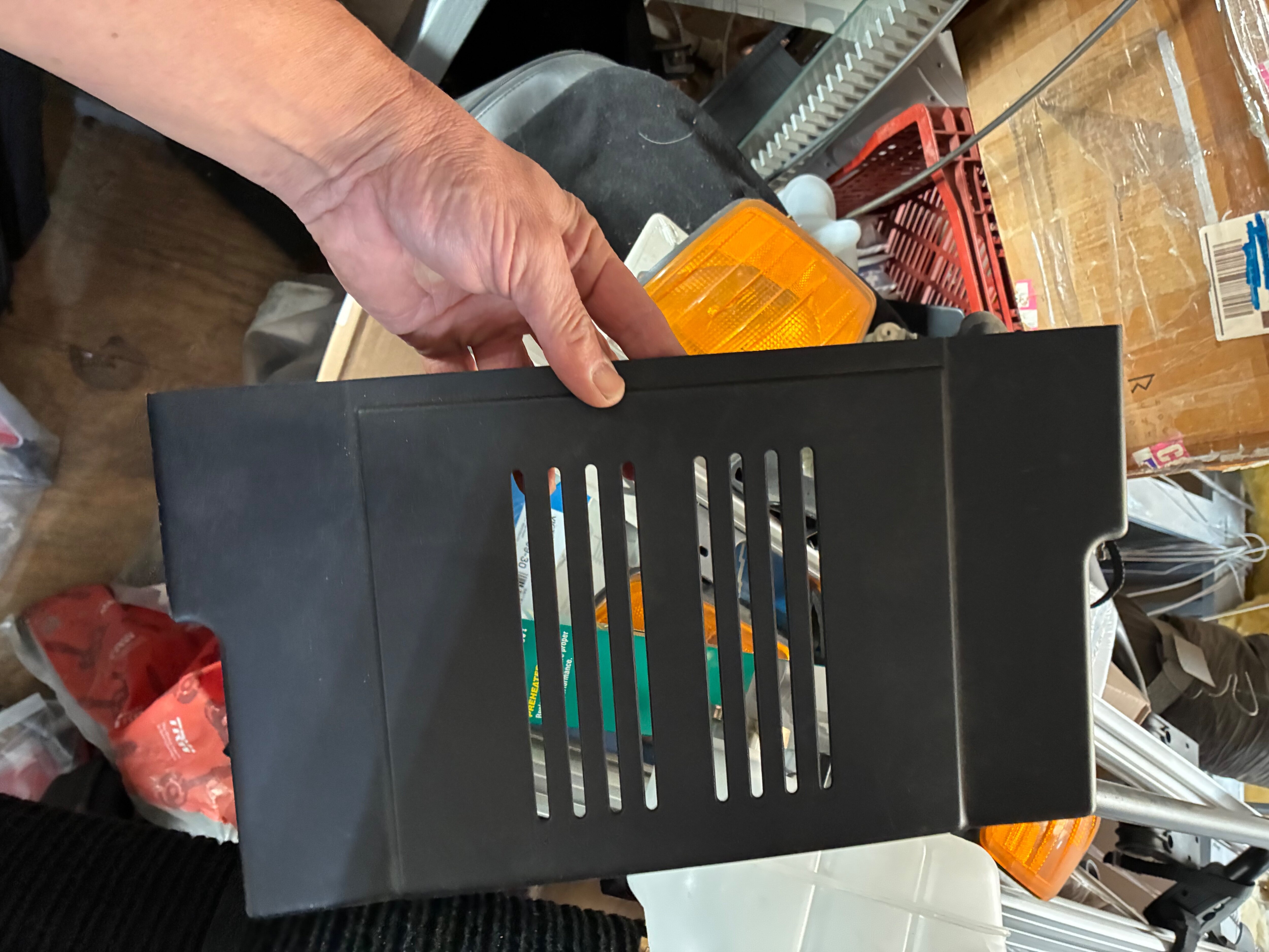

Removing/installing the air intake scoops that fit down into the above plastic pieces. This is the piece that was mentioned earlier in the thread, that I have one (driver's side) for sale. This is an NLA piece.
You can see the groove where the top part of the plastic air intake scoop presses into, immediately above the rectangular silver sticker in the image below.
