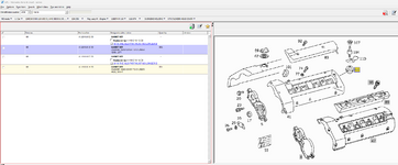

I need x2 #111-051-00-43-MBZ
And x2 #104-990-10-04-MBZ
I was also wondering what other gaskets I may need for my mechanic to have the ability to dive into this job once.. lol
The P/S reservoir has to come off to R&R the driver side cam solenoid, so you'll need that gasket. Mechanic will probably want a new O-ring for the pipe behind the reservoir too. If the short hose between reservoir and tandem pump is not new or recent, replace that at the same time - it's an incremental hour or so labor.
The front head covers do not have to come off, nor the valve covers, however it's NOT easy to hold the armature to allow torqueing the center bolt with the head covers in place. If your mechanic wants to remove both, add a few hours labor plus new OE valve cover gaskets.

Thanks for that Dave!

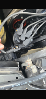

My car has been down due to a badly leaking camshaft solenoid. Finally got the parts in and we are going with new oem plugs- however, the ones we removed had different numbers on the ceramic portion. New ones are the same?
Factory gap on the plugs are un even so we need to re gap them as well
I also bought a new one oil filter, and some fresh oil. (5w40)

Gap each plug at 1.0-1.1mm
The plugs look correct for the application. They look like the correct and current French-made, factory, Beru plugs. The numbers on the ceramic portion of the plug don't matter a whit. What matters is the MB part number on the box, and the F8DC4 on the metal portion of the plug.
The oil is fine, although in your climate I'd prefer to see you use a 10W-40, 15W-40 or 20W-50 oil. 5W-40 is better for colder (more northern) climates, freezing/winter-time temperatures. Hopefully you also have a factory MB, Hengst, Mann or Mahle oil filter to go with that oil.

The tech pulled the rotor, and the metal part behind it came out clean without un threading the bolt.

Looks like someone had used RTV on the cam solenoids previously? Only use anaerobic sealant when installing the new ones. And, don't forget the armature needs to be replaced if you are using the new-style (119- part number) solenoids.

I believe they installed the new style armatures on both sides and I regretfully didn’t order new ignition components aside from a new ignition rotor (which I’m glad I got) so I placed an order for new distributor caps.

The mechanic sent me this picture:
I guess the Beru wires don’t like being pushed in and pulled out more than a few times?

Yikes. Someone got hamfisted with that wire. The boots "stick" to the cap tightly, you must twist them loose first, then gently pry off from the opening of the boot (by the cap surface). If you pull hard on the outer end of the boot, they could be damaged, as shown here. Still, I'm surprised to see that drastic of a break unless the mechanic used pliers or something - which is user error, not a defective component.

Here is the ISPPI entry for the M119 (.97x) valve cover gaskets:
