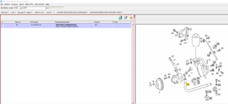

New problem. The hose coming out of the Tandem pump in NLA. 124-320-91-53
Starting a search now.....
124-320-91-53 is the high-pressure hose. It almost NEVER leaks and should never need replacement. If it does, a hydraulic shop can rebuild it. Don't bother trying to source a new one, I think it's been NLA for many years.
The leak points are the low-pressure hoses in the system... short one above the pump, S-shaped from pump pipe to frame rail, and the one at the steering box hidden behind the heat shield.
Are the 3 return lines just "hose" or do they have fittings at each end? I will have the tech replace all of them.
We are not certain the pressure hose is leaking, it may just be residual oil trapped around the adel clamps that retain it.
The only one of the lines with fittings is the NLA high pressure hose.
The short hose that connects the PS portion of the power steering pump and the reservoir, and the frame rail hose, are lengths of straight hose with no fittings.
The “S” hose is pre-formed hose, and also does not have fittings; however it does have a piece of corrugated flexible aluminum heat shield around it with cut-outs for the clamps.
It is not fun to get to this “S” hose to replace it, but possible. Same with the frame rail hose — it will make any good tech sweat loudly. I tried for about 10-15 mins to tackle mine for a proactive replacement, but gave up as it wasn’t leaking.
