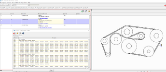

Ah, that explains it. The 129.066 uses a 6-rib belt in different lengths. EPC screenshot below.
Should be 2523mm long with catalysts (due to smog air pump)
Should be 2176mm long without catalysts (bracket/pulley in place of pump)
Correct tensioner pulley is 601-200-07-70. Your pulley is wider than normal, but I don't know if the diameter is the same or not.
You still need to release tension and see what's going on there, along with re-setting the plastic indicator per the FSM procedure.
