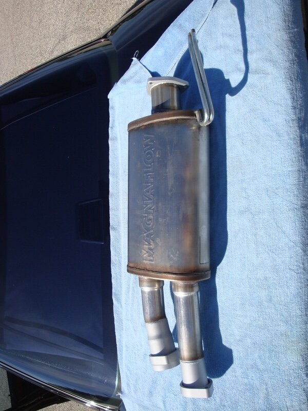

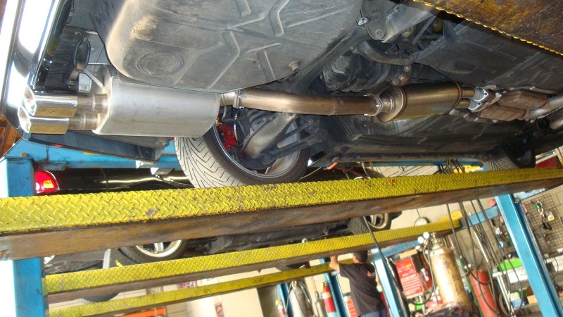

I had an exhaust fabricator who did custom dune buggy exhausts in Costa Mesa put my OEM resonator in a jig and cutout the resonator and weld in a Magnaflow SS Muffler for a Chevy Camero. The new resonator fits exactly in place of the OEM resonator. Notice the silver painted OEM connections from the Mercedes resonator connected to the Camero resonator. My Renntech back box came off of an 500SL and required an additional 3" SS Pipe to be fitted between the back box the Camero resonator.

@WorkOfArtLA
View attachment 239037View attachment 239039View attachment 239040n
This, ladies and gentlemen, is how it should be done in concept. Mine used a large MF muffler as the resonator, with a small MF at the back. Quiet around town, throaty when you get on it. But I put high flow cats in favor of the factory, then had some 2:1 merge pipe to go 3" to the back.
