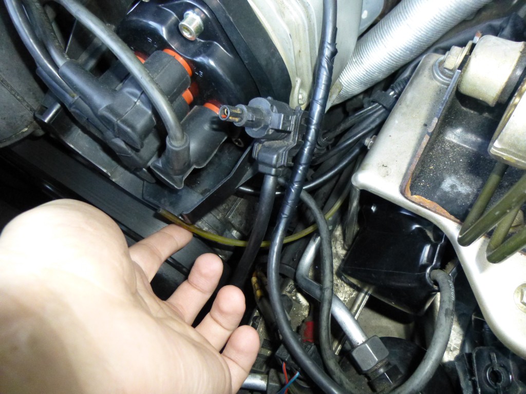

2. This (vacuum?) hose is broken. I have a similar hose at home, but I can't reach into either end of it to replace it. It's also too brittle. There is enough room for a heatshrink, however. Worth noting dealer found no vacuum leaks 1 month ago, but I doubt this is a new change since I never checked there. Do you know what it is for and if it's not vital, a heatsrink will be enough? The other end is under the plastic and cap, 2cm inward from the V-belt.

1) The IAT sensor is not super critical. If it were not working, there would be an error code. If the readings were off, it still wouldn't cause any major change in engine operation.
2) That broken vacuum line IS critical and is likely a good portion of the reason why your MPG is low. That vac line goes to the EZL. No vacuum means retarded ignition timing, and reduced MPG, and reduced part-throttle power. Use a short length of rubber hose as a short-term patch, but when possible, replace the entire length with fresh vac tubing (it's cheap). Once it snaps, that means the whole thing is brittle and will continue to snap apart somewhere else.
WOW... thanks a lot for the tip. I will definitely look on patching this as soon as possible (this week, if I can't, the weekend for sure). I do have reduced part-throttle power. thx thx thx

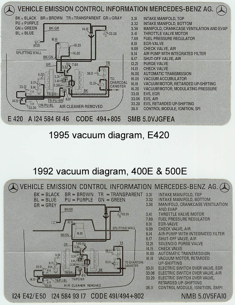

Any place I can find a diagram or something how to replace the entire tubing? I do have the same diameter tubing at home, but I don't see either end of the tube in my engine or how to replace it.
The FSM has some diagrams, plus there is a decal above the driver's headlight that has a partial diagram... shown below:
Note the two are nearly identical, the vacuum plumbing for all years .034/.036 is basically the same:

2. Changed the end to the EZL of the vacuum hose with a rubber one. I don't know if there is another break further down the line, there seems to be inadequate power <3000 RPM unless I floor it. I will inspect the diagrams and see if I can get a new vacuum line from the same source.

Easy test... with the engine running, remove the vacuum hose at the EZL. Place your finger over the end. You should feel vacuum sucking the hose onto your finger. No vacuum means a break somewhere else, likely between the intake manifold halves, as this particular vac tube runs to the very back & bottom of the intake. Almost impossible to access without pulling the ETA.

I changed my ETA 3 times and didn't replace this................... sigh. I'll test the vacuum and hope for the best.
EDIT: Lucky for me, vacuum is good. I will still have to replace the line at some point. Adding my diagram for reference.
Vacuum diagram 1993 400E
