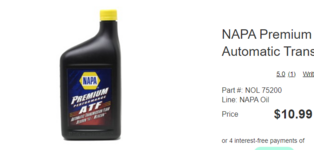

I buy my fluids from Napa using the store brand. Especially when they have a sale. The oil they sell comes from Valvoline. I think the last time I bought Dex III it was $5.49 a quart. For euro cars I typically use LiquiMoly in the weight specified by the manufacturer as well as making sure the oil has the manufacturer’s approval. Have you seen the new Toyota motor oil? I believe it’s 0W-8

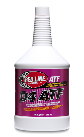

These are also fine and meet the Dex III spec. I do NOT recommend using fully synthetic ATF in your transmission unless it is the first fluid using when rebuilding the transmission (new seals).
If you were to go FULL synthetic, I would use RedLine's D4 fluid, which is also fully Dex III compatible. Note RedLine's compatibility list below.
I would also trust this fluid:
