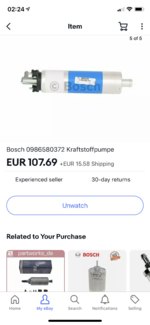

Before you buy a fuel pump, remove the plastic cover and verify your car has the 1-pump setup. The single-pump part number is 000-470-59-94 (supercedes to 000-470-78-94) and does not look like the one you posted above (Bosch 69435), which appears to be for the dual-pump setup.
The fuel filter is also different for 1-pump vs 2-pump systems. If you have 1 pump, the fuel filter should be p/n 002-477-27-01 and will have a hose barb on each end.
Again, without measuring fuel pressure while driving, there's no guarantee it's a fuel supply problem! But after 25 years, it's not a bad idea to replace these items proactively.
