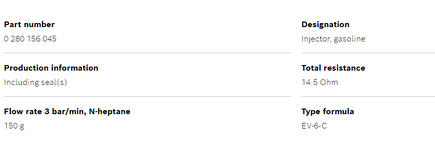

If I remember correctly our injectors are 200cc 14.5ohms.
I found pdf online that says this injectors are also 200cc and 14.5 ohms resistance.
Bosch #0-280-156-045
Like the now NLA blue thin body injectors that goes by the number 0-280-156-024.
Just checked bosch parts catalogue and it's actually 150g/min and this is around 220cc. Not exactly 200, but close, wouldn't the ECU be able to correct this?

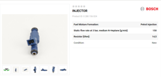

The last letter describes the pattern as seen here.
Here is another injector that is correct EV6E 150g/min and 14.5ohms #0-280-155-823. With this injector operating pressure is also listed. Sadly there is zero information about the height. Still 3.5bar is tiny bit to high for our cars.
Here is the pdf that I found with injectors resistance and flow listed. (PDF) Bosch Injectors and Ohms - DOKUMEN.TIPS

I sadly wasn't able to find anything. I only saw in that one pdf that they are the same spec and that's all. 0-280-156-024 injector no longer even exists in the bosch online parts catalog and there is not much information there anyway, so I really can't compare them side by side. I found some info else where and the only difference is that 024 is EV6E and 045 is EV6C.
View attachment 181425View attachment 181427

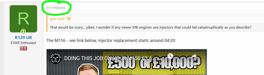

That would be scary... yikes. I wonder if any newer MB engines use injectors that could fail catastrophically as you describe?
The M156 - see link below, injector replacement starts around 04:20:
Worryingly, reading the comments, there is no obvious sign that the injectors that can fail open have been redesigned etc. and if it can happen at very low miles, new ones could equally fail.
