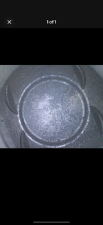

As the title says, does anyone have pictures of the Pistons from a 500 AMG 6.0?
A seller is claiming their 500e has the AMG 6.0 engine. No paper to back it up though

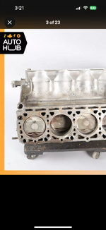

They took a borescope and They’ve shown me a picture of their piston top, which has round indent, and looks different from the traditional M119 piston top That has a rectangular indent between the valves (sample factory m119 pic attached here )
Does anyone have pictures of the AMG 6.0 pistons? Are these custom pistons? Could they be renntech?

Piston appearance is irrelevant. You need a measurement of the stroke. Whatever car is for sale, have you searched the VIN on this forum?
AMG 6.0L engines are stamped by AMG... no stamps, no AMG engine. These will also have AMG-marked camshafts.
I'm not familar with the round-indentation pistons. Wonder if those are the lower-compression pistons? Weird.
