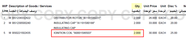

here is the pdf of what i am getting for eletric things 👇

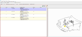

Your PDF shows qty 2 of the same coil part number. This is incorrect... the 2 coils are not the same. See EPC screenshot below. If you are only replacing 1 (I'd replace both since you have them both out!), make sure you are getting the correct part number.

that pretty expensive.Can you send me the right part numbers for the coil packs i cant find them on mine and ill check the ezl hose out

Damn you GSXR! Reading the pdf I now (because it's been a minute since i changed them) can't remember if the part numbers were different on the ignition coil! Bawahaha But thank you! Thanks for the WIS!
