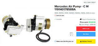

Thanks! Interesting design, it only replaces the air pump, and uses the existing bracket. THis is different than the factory solution but may use the standard belt length (I think the factory setup uses a different belt length). €280 w/VAT, maybe ~€240 without VAT. Probably €300+ with shipping/tariffs to USA, $350-$400 USD total delivered? Suddenly a reman air pump doesn't look that expensive.
