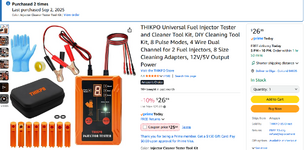

I removed all the fuel injectors and tested them with a cheap fuel injector tester from Amazon. Please see picture below.
None of the injectors has a pulse. I thought the tester was defective and ordered a replacement. Same thing, no pulse! Tested with two known good batteries. Since I am getting spark, fuel rail pressure and the signal to the injectors, defective fuel injectors make sense why the engine doesn't start.

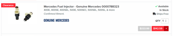

But what would cause all 8 injectors to go bad???? I'm worried to order all new injectors install them and I fry them!!!!🧨:fun:
FCP has a clearance for $143 each.
All the removed injectors have part#000 07 87 823
I find it extremely hard to believe that all of your injectors have failed, I would put money on a cheap Amazon tester that is not designed for the injectors you are trying to test. Have you considered just hooking the injectors up to power directly (momentarily) and seeing if you can hear the injector open? Also is it possible that you hooked up the injectors to the tester with reverse polarity? They will not work if polarity is reversed.
If you supply the injector with 12V and ground from a car battery directly, to the correct terminals on the injector, you should be able to hear an audible pulse/click. Remember to only power the injector momentarily as to not burn the injector up.
DO NOT spend $1200 on new injectors! :run:
190EVAN is correct. Seems very unlikely all of your injectors would fail simultaneously. It appears the Amazon tester just applied the 12V pulse more easily than rigging up your own wires, and you are just listening for a "click" when energized - correct? No click, no fuel. It wouldn't hurt to try testing one injector directly off the vehicle battery, again just a brief time energized... should click when voltage is applied. Make sure the polarity is correct as noted above.
If for some reason you do need replacement injectors, you could either send yours in for cleaning / testing as described here, or buy a set of GB Reman injectors for ~$300/set. The only thing I can think of is that you had ethanol-blend fuel go stale while in storage which gummed up the old injectors, but this seems unlikely... I've had ethanol fuel in cars that sat for years and never had a problem (not that I recommend trying this at home, kids).

Tested all the injectors directly off the vehicle battery for just a brief second. Injector is labeled with the positive pin, therefore I'm sure the polarity is correct.
Injectors are dead, no click or pulse! Changed polarity and still nothing. Ebay is selling remanufactured Injectors Bosch#280155217 for $159 for the set. I will probably order them and if the engine starts, I will send out my original injectors for repair.
