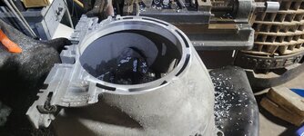

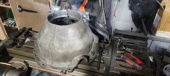

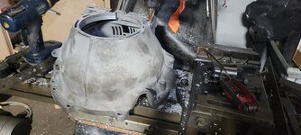

I have a m119.960(a few actually) that's been waiting for me and my skills to be ready to use it. It's going in my new drift car build, still not fully decided on a r107 or a w114 coupe(frame rails are a problem for a V8) with a mustang t5 trans. Actually not a super complicated swap if you have a mill. The 722.3 auto bellhousing (with machining) and all the mustang parts are somehow magically dimensionally basically perfect.

Here's a pic of the bellhousing near finish machined for the manual swap. Waiting for the .625" plate that will be bolted on and register into the pump bore to arrive. I can go into details on that if anyone is interested in swapping an alloy m117 or 119 car.

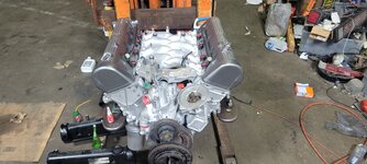

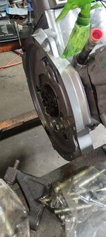

I also just finished a timing freshen up and minor port clean up on a 117.967 560sl engine with a custom rear plate to run the iron block 350sl manual trans that's in the 450slc to hold me over while I build the new car. Almost finished reassembly on that, it's going in the car shortly.
