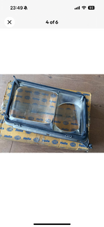

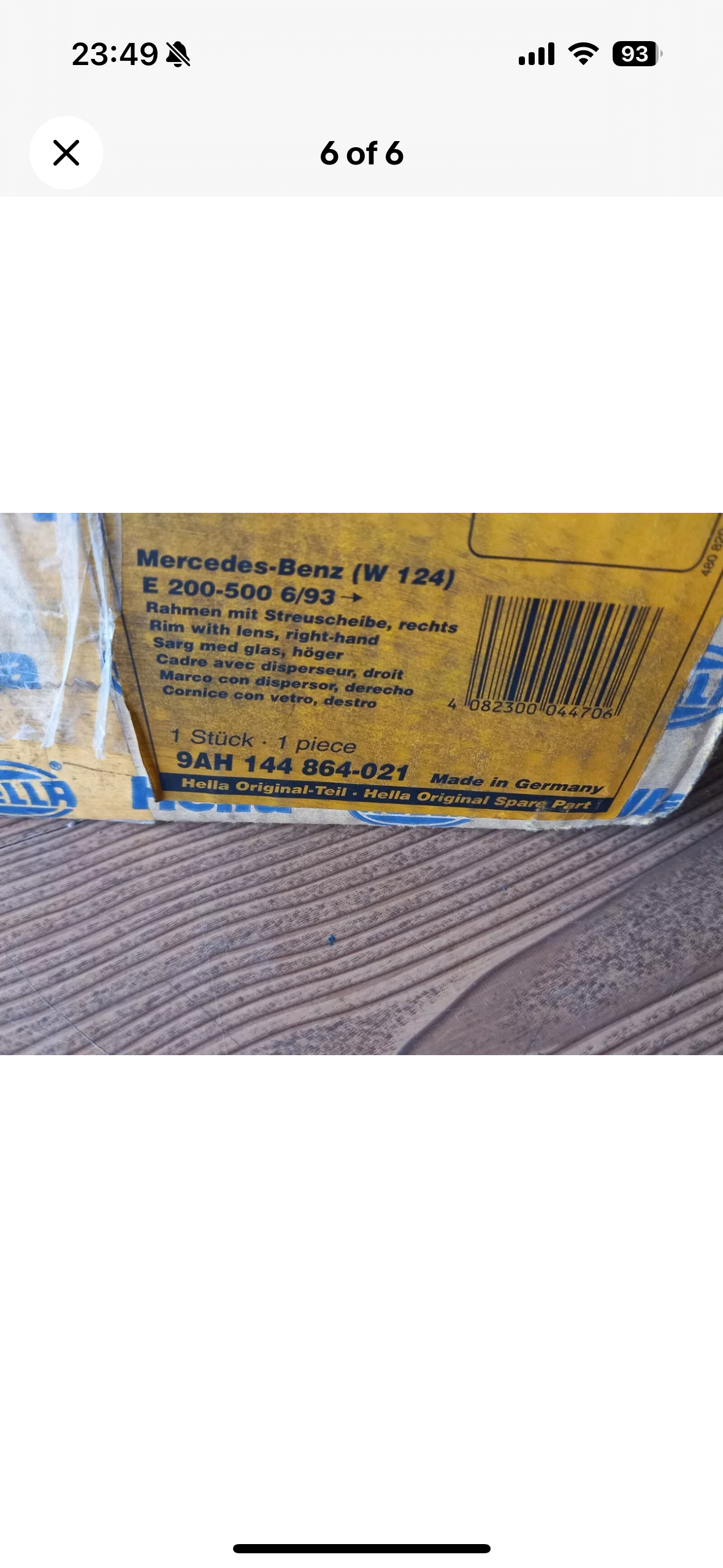

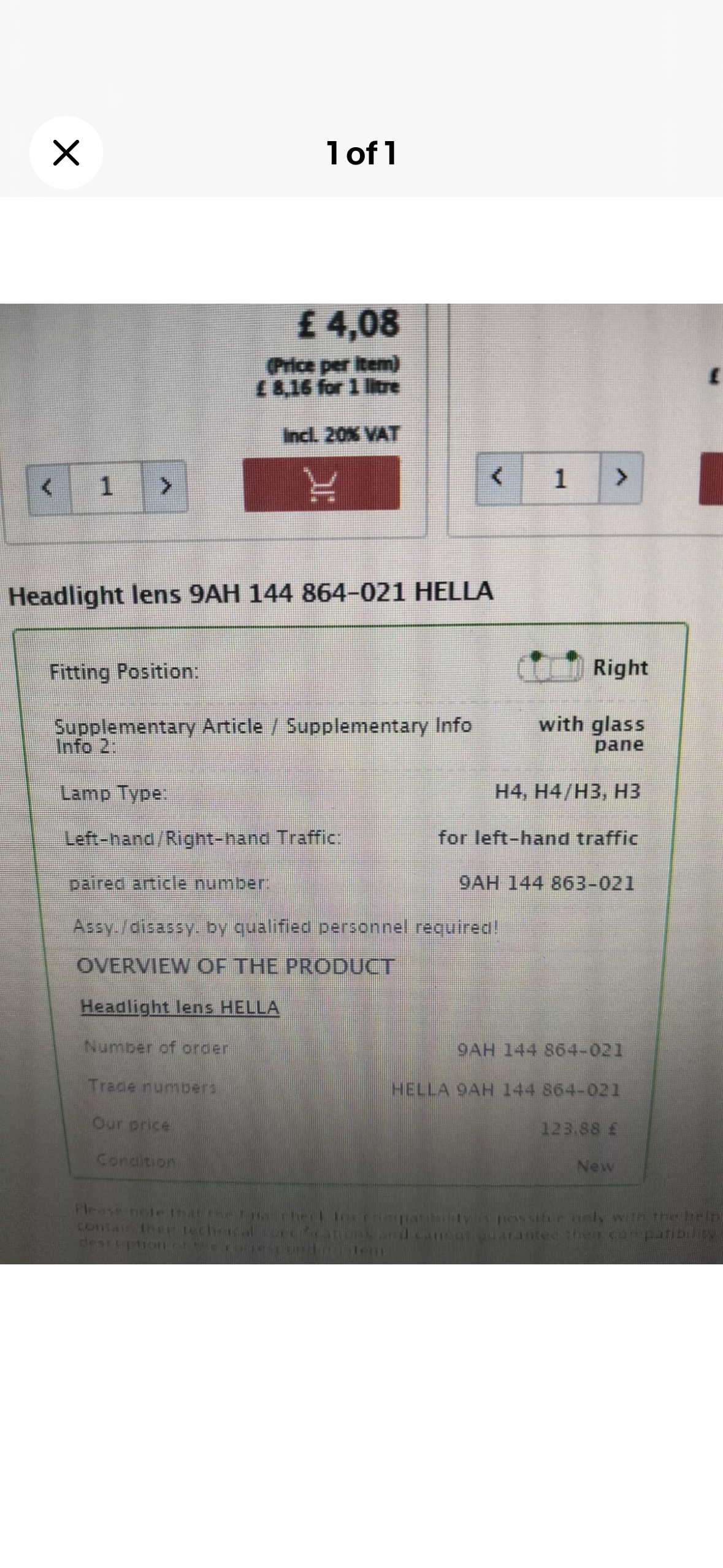

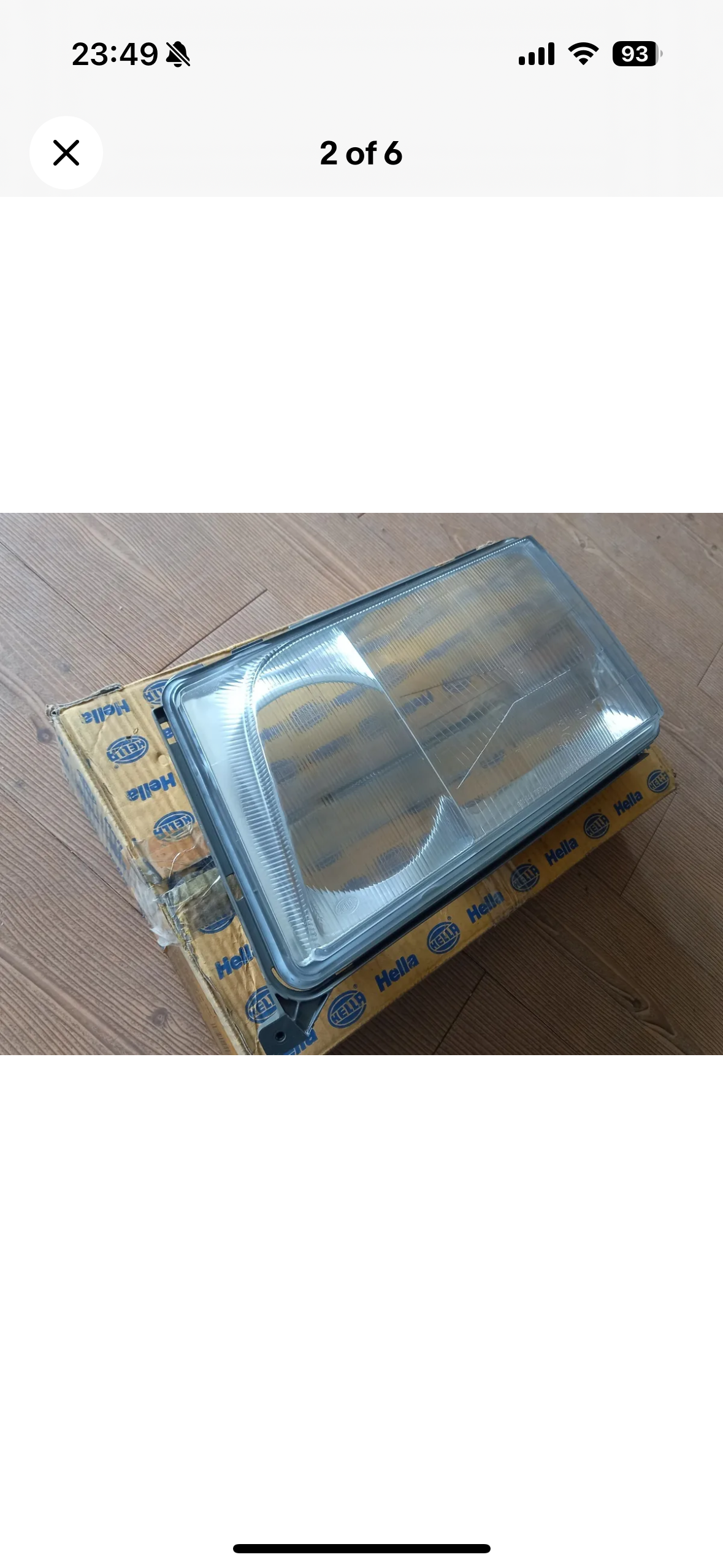

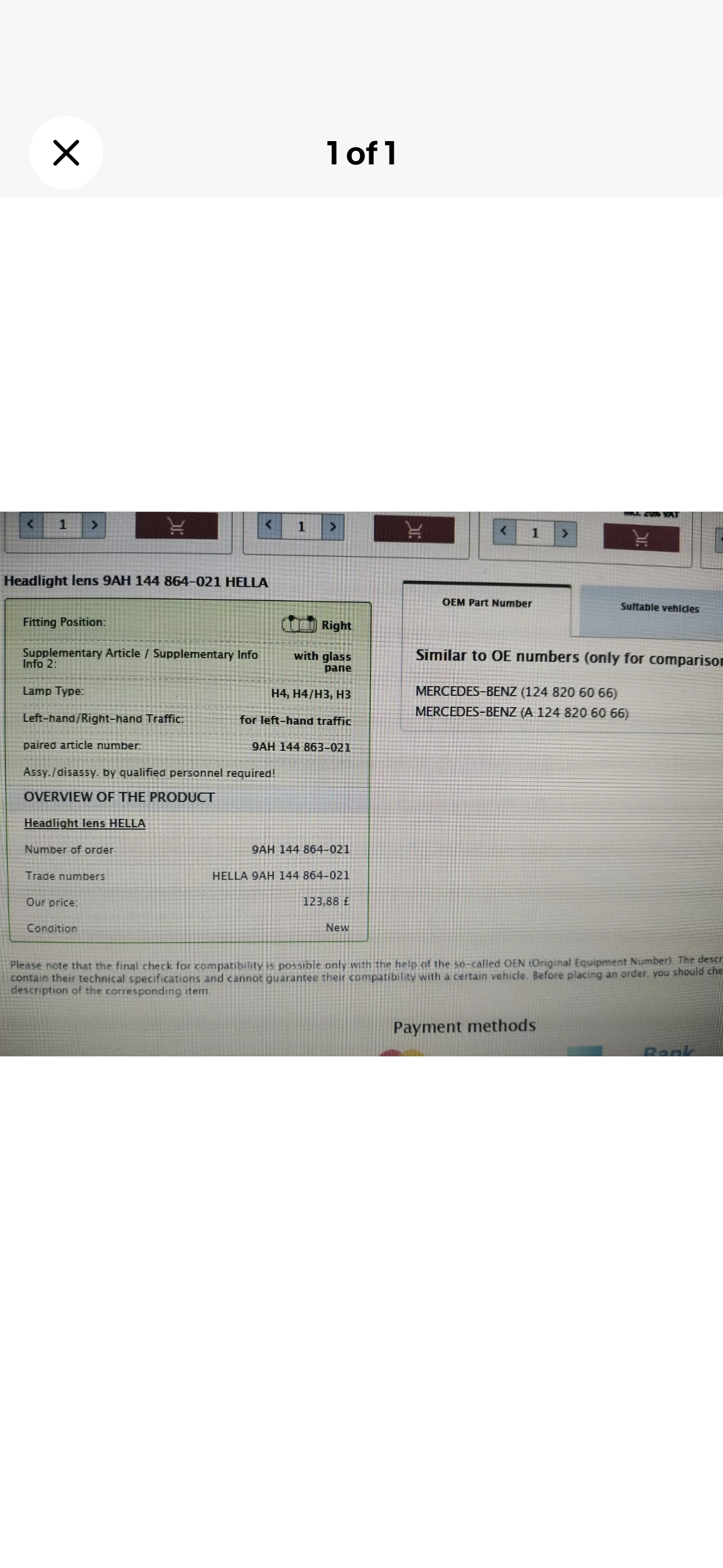

This is what seller sent me(attached pictures), he ask 700€ for one lens.
€700 for a single lens, €1400/pair! That's crazy. You can get the pair for €500 from the eBay seller. Unfortunately that doesn't help since the lenses for sale are LHT... not what you need for Croatia RHT.
I prefer the £124 price shown on their screenshots (still doesn't help, because LHT):
