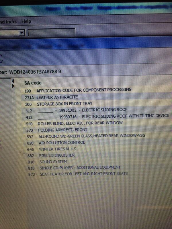

Guys, can you help decode , please, to establish origin: WDB1240361B746788

Data card :
Hope it's readable
Looks like first delivery was Fulda, Germany , code 218
